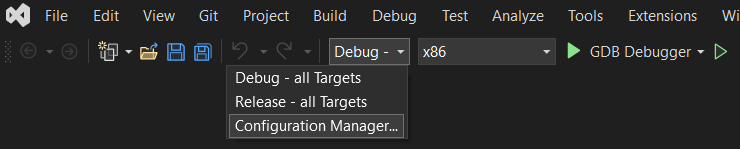

As a quick workaround, you could start a project without a target and add a solution configuration manually named Project-specific”. After that, it should be possible to add targets to the project and work as usual.
Open the configuration manager:

He Martin, thank you for your help! This fixed it.
