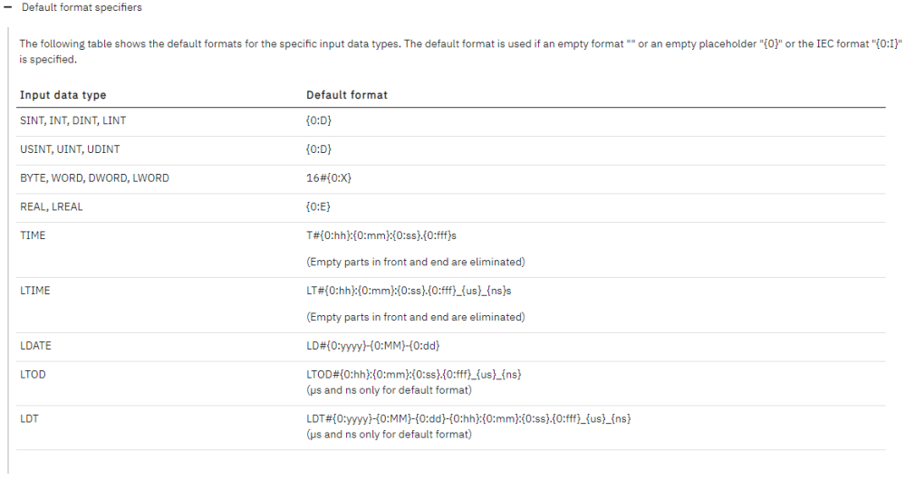

    All you need is in TO_STRING help page, FORMAT STRING / Date and Time format specifiers.... And format string '{0:hh:mm:ss}' or '[{0:hh:mm:ss}]', to reduce CONCAT usage.

    It seems you are right, and there is no appropriating format string for TIME process in manner you expect....

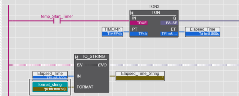

    I attempted to set up your problem -- I simplified it to just be a timer (instead of countdown timer); I got the same results as you...there is no output from the To_String function with the '{0:hh:mm:ss}' format.

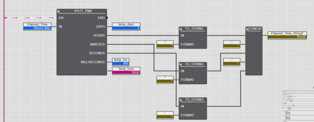

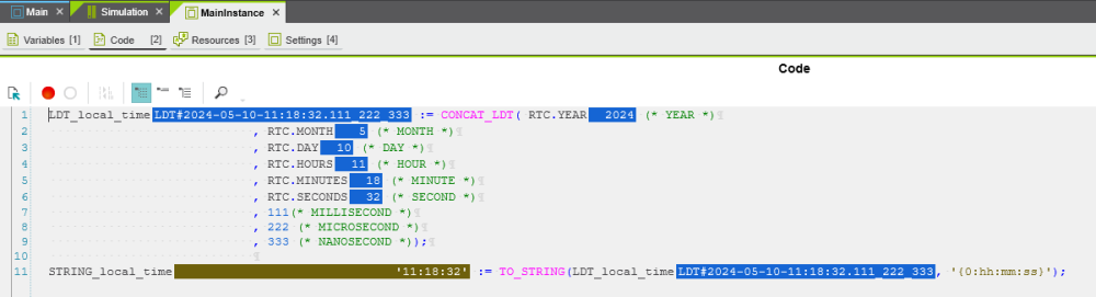

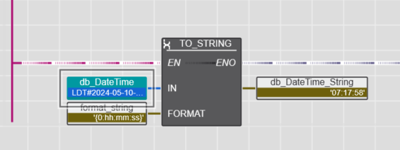

    Out of curiosity, I used the same format string '{0:hh.mm.ss}' to a LDT variable (not just a TIME data type) and the output worked:
    One way around this might be to use the SPLIT_TIME function, convert the pieces to strings, and then CONCAT them. A little cumbersome but it works...
