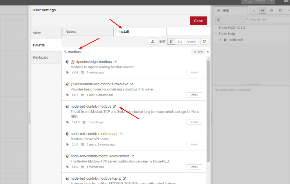

Hello
We indicated the procedure attached to customer and everything works well (only in Portuguese)
But the version of NodeRed is old and some packages not works

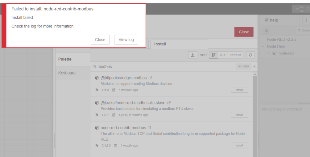

2024-10-02T12:24:57.739Z Install : node-red-contrib-modbus 5.42.0
2022-03-11T16:05:28.497Z npm install --no-audit --no-update-notifier --no-fund --save --save-prefix=~ --production --engine-strict node-red-contrib-modbus@5.42.0
2022-03-11T16:05:38.626Z [err] npm
2022-03-11T16:05:38.629Z [err]
2022-03-11T16:05:38.631Z [err] ERR!
2022-03-11T16:05:38.633Z [err]
2022-03-11T16:05:38.634Z [err] code
2022-03-11T16:05:38.635Z [err] CERT_NOT_YET_VALID
2022-03-11T16:05:38.639Z [err] npm
2022-03-11T16:05:38.641Z [err]
2022-03-11T16:05:38.643Z [err] ERR!
2022-03-11T16:05:38.644Z [err]
2022-03-11T16:05:38.661Z [err] errno CERT_NOT_YET_VALID
2022-03-11T16:05:38.864Z [err] npm
2022-03-11T16:05:38.867Z [err]
2022-03-11T16:05:38.869Z [err] ERR!
2022-03-11T16:05:38.872Z [err] request to https://registry.npmjs.org/node-red-contrib-modbus failed, reason: certificate is not yet valid
2022-03-11T16:05:38.941Z [err]
2022-03-11T16:05:38.944Z [err] npm
2022-03-11T16:05:38.945Z [err]
2022-03-11T16:05:38.947Z [err] ERR!
2022-03-11T16:05:38.949Z [err] A complete log of this run can be found in:
2022-03-11T16:05:38.950Z [err] npm
2022-03-11T16:05:38.952Z [err]
2022-03-11T16:05:38.953Z [err] ERR!
2022-03-11T16:05:38.954Z [err] /data/.npm/_logs/2022-03-11T16_05_38_886Z-debug.log
2022-03-11T16:05:39.002Z rc=1
Someone can help me to indicate some procedure to update the Nodered ?

Something similar was discussed recently, here:
Certificate errors are often caused by the date/time being incorrect on the device.
What is the current date/time on the PLCnext Control device?
