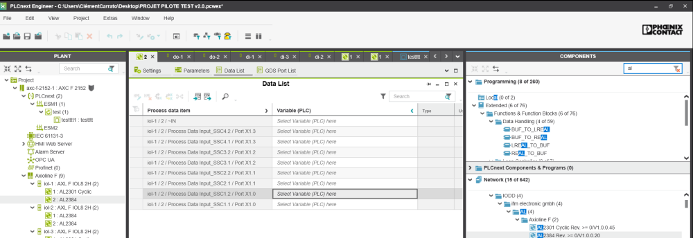

Hi all
I am trying to load IODD config file from a IOLINK module IFM (AL2384) to the IOL-8 2H card to read temperature transmitter P100 4 wire from IFM.
https://www.ifm.com/de/en/product/AL2384
No error after importing the file, IOL-8 card is all green as well wired with IFM module.
However, the 4 analog inputs are not listed in the process data item (see screenshot below) while they are well register as float32T in IODD file (page 3 pink lines) , only booleen items show up on items list (page 3 blue) https://www.ifm.com/download/files/ifm-0005AA-20250122-IODD11-en/$file/ifm-0005AA-20250122-IODD11-en.pdf
What goes wrong during the import?
