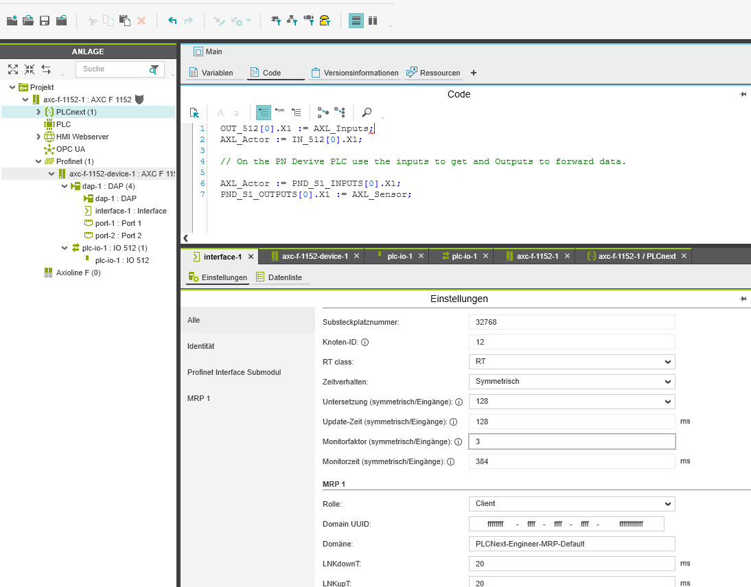

Hello hhchien, you could use PN. Add one PLC as a PN device to the other PLC. And then use the Input Output IO to forward the bits of your switches. Might be a little overkill but its quite easy to setup for beginners more configuring then programming… [attachment]30-04-_2021_09-46-03_2.jpg[/attachment]

[quote]Hello hhchien, Switching a page is not possible as you can not remote controll a browser but you can display a variable change - yes. I recommend having a look at the Infocenter and the available gettingstarted guides. https://elearning.plcnext.help/PLCnEng_eHMI/story.html PLCnext Engineer Basics https://store.plcnext.help/[/quote] HI Oliver, I can’t seem to connect the two controller together by profinet. On the device page i see it as active out haveing error code 0x0023 Thank you,
Hello Hhchien, did you asign the names to both of your PLCs? have a look here for some help: https://www.plcnext-community.net/en/discussions-2-offcanvas/i-need-some-help-to-communicate-plc-in-profinet.html I am sure your local subsidiary is happy to give you a short introduction how to work with the PLCnext Engineer, PLCs and PN setup in general. kind regards, Oliver
