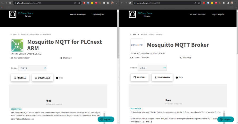

I noticed there is 2 different Mosquitto MQTT app’s in the store, both published by Phoenix Contact.
Does anyone have experience with one of them or both? Or does anyone know why there would be 2 versions. (I’m working with a AXC F 2152 - as there are even more versions for other controllers)

please use Mosquitto MQTT for PLCnext, this one is the newest app. The other app is deprecated and only works with Firmware 2020.0 LTS. We will archive the old version within the next days. Do not hesitate to contact me if questions arise with the Mosquitto MQTT for PLCnext app and make it a great day!
