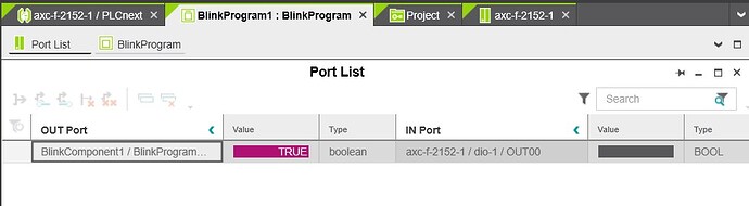

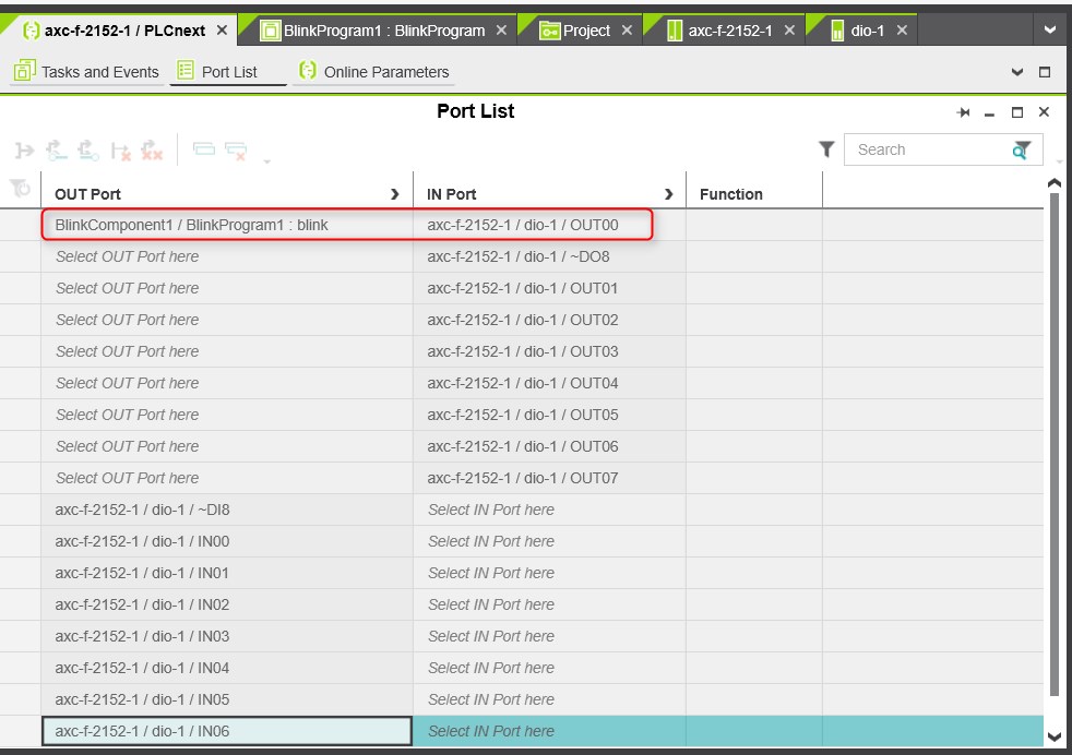

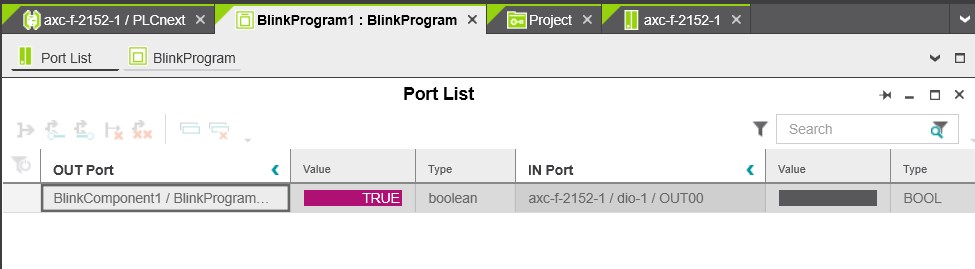

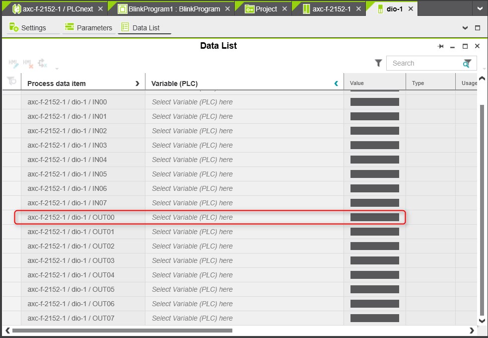

4. Define the physical I/O In PLCnext Engineer, define the physical I/O like you normally would for a PLCnext Engineer project. Here is an example showing an 8 channel DI/DO module: 2020 02 16 130026 5. Connect the C++ port to a digital output In the PLCnext → Port List window, connect the OUT port from the C++ program to a physical digital output. Here are before and after pictures of a connection between the C++ port and the first digital output (OUT00) on the I/O module: 2020 02 16 130437 2020 02 16 1307 6. Download and run the project After downloading the project to the PLC, you should see the digital output blinking. Let us know if you have any questions about any of these steps. ~ Martin.

I actually found that I needed to change the order of the modules. I attached a picture of where that is. Thanks again for your help!
