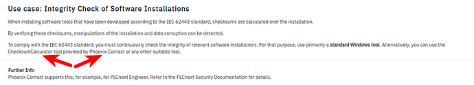

Dear ,
I found this thread trying to accomplish a similar goal, though slightly different.
Is there a way to check that the binaries inside of:
C:\Users\Public\Documents\PLCnext Engineer\Binaries\Project@binary\RES\Configuration\Projects\PCWE
are from a given PCWEX file?
In other words, if I have a PCWEX file, I want to be able to preform a check that I have compiled the project, and that it is currently in:
Best,
Ethan

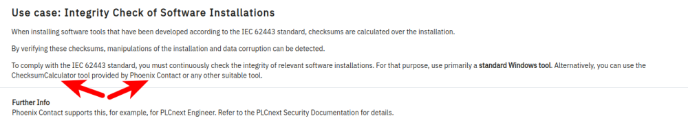

Is this actually a thing?
https://engineer.plcnext.help/2023.6_en/_index.htm?iframe=https://engineer.plcnext.help/2023.6_en/AboutThisDoc.htm
