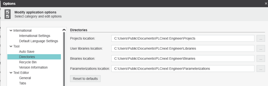

The Directories - User libraries location: is unchanged and and is the default link.

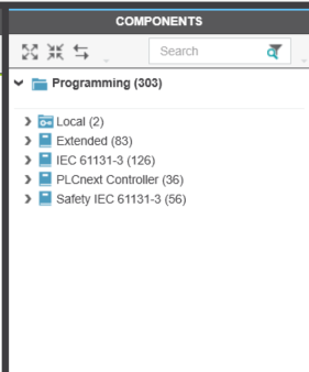

The problem is precisely in making the function visible.
I expect I’m doing something wrong here but I can’t seem to find a clear explanation on how to do this.

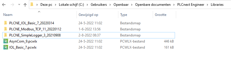

Hi Stefan,
I have tried both options but the new function is not visible in COMPONENTS. The field remains unchanged even after PLCNext is restarted.

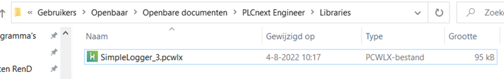

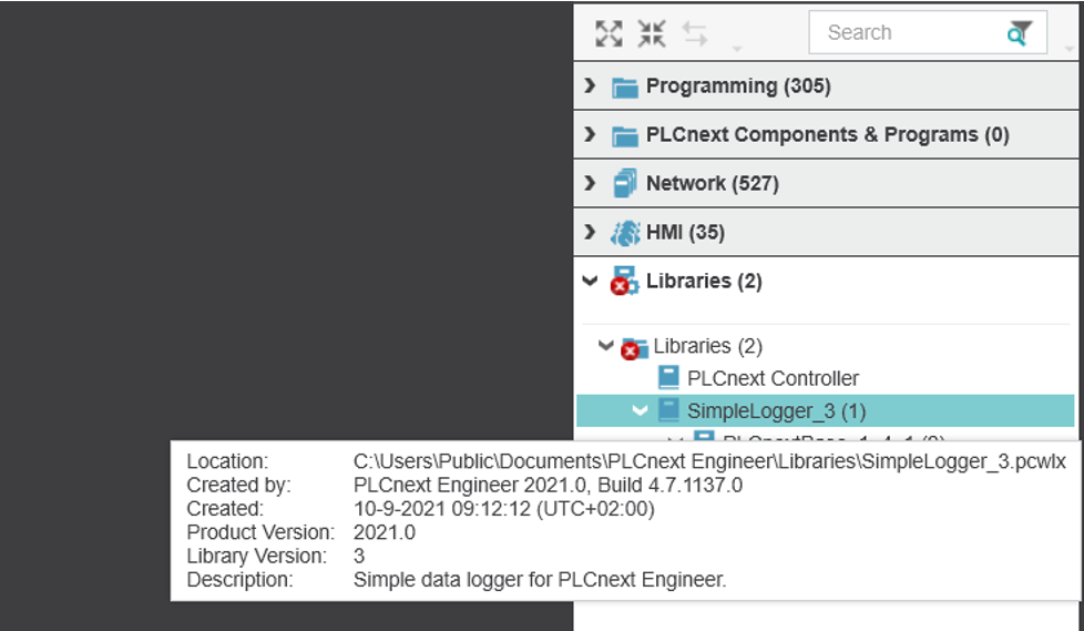

Thanks a lot for the instructions that’s exactly what I was looking for. Unfortunately it does not have the desired result.
If I go through it step by step I get the following.

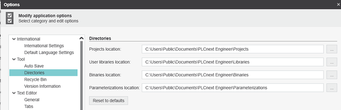

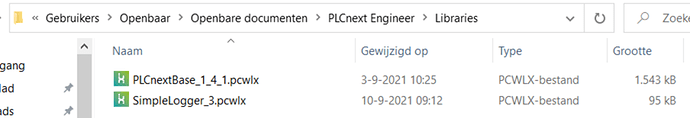

However, the file location is set correctly

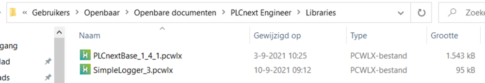

Well there is no PLCnextBase_1_4_1.pcwlx in your folder.
Maybe try and put the library next to the SimpleLogger3.pcwlx?

Please copy the PLCnextBase library into the same folder. It is included in the download of the SimpleLogger library.

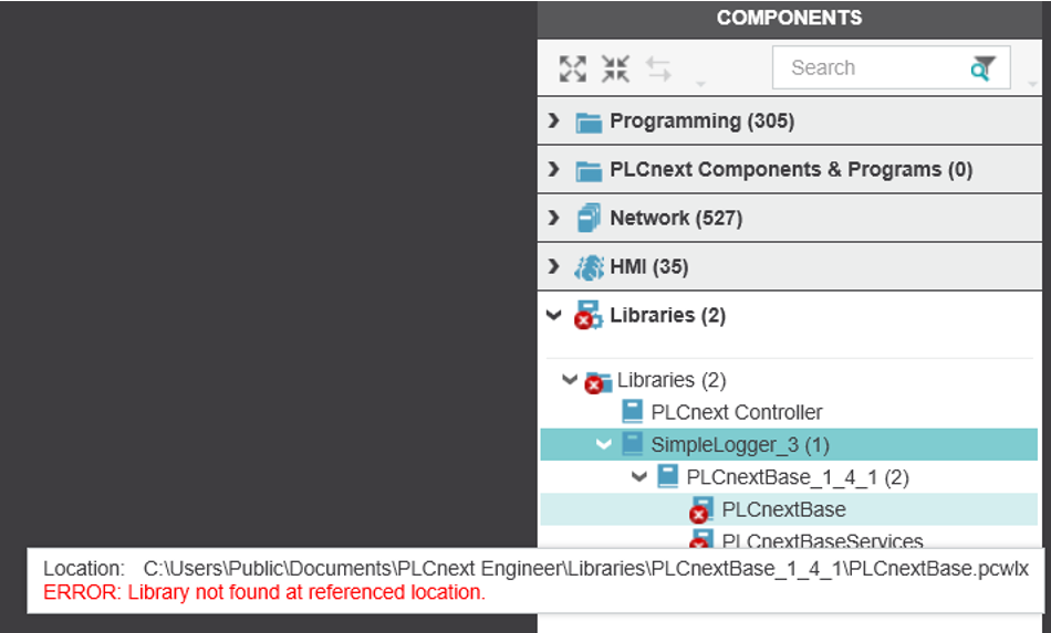

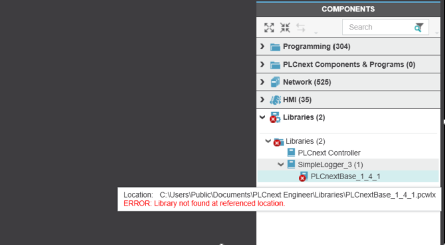

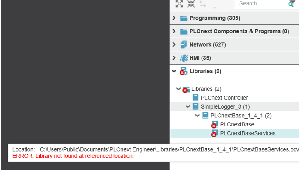

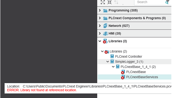

Thank you very much for your support. Now I get the following messages.
Is there anything else I can try or test? Could it be the Windows language setting?

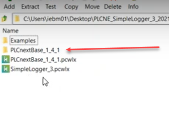

In the download there is a subfolder integrated. This subfolder must be copied into the library folder.
Yes, this is the folder that must also be copied to the Libraries directory:

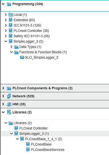

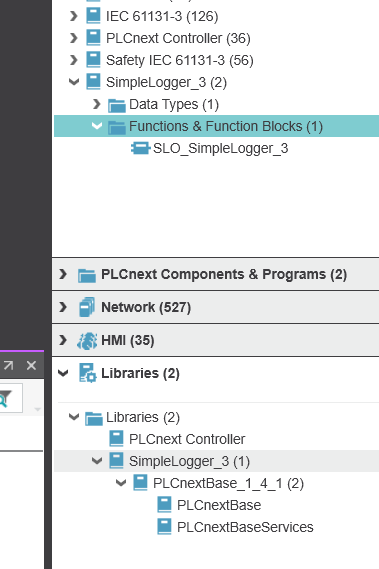

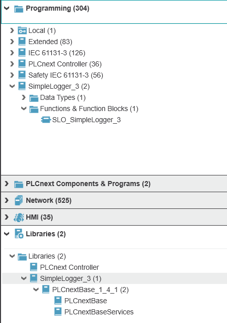

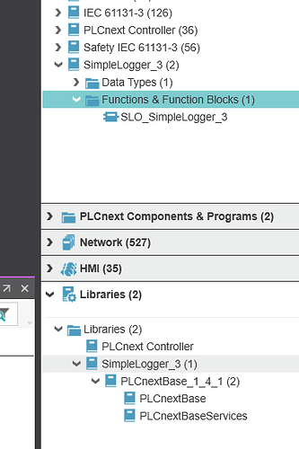

Now it works, thanks for your help and patience you all.
