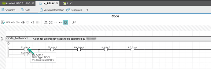

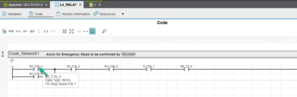

When I program in Ladder I only see the Variable Name, I cannot see the Comment displayed in ladder, I have to hover over each Element to see the Comment.

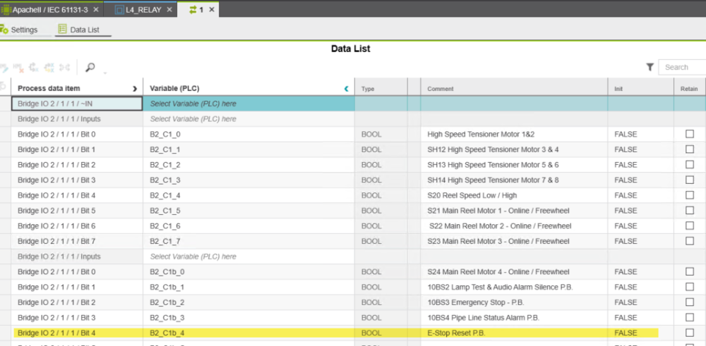

As I am building a system from an old system all my PLC Variable names IO References like b2_C2_B4 ( BridgePanel2_Card1b_Bit4) so I know where to Wire. But this has a function such as EStop pb Associated with it. Can the Comment be displayed about each PLC Variable ( like it does in RSLOGIX ?)
You are not missing anything. I asked this question a year or so ago. I think mentioned comments were not displayed when you use NOLD programming worksheets.

Martin - So - now written in LD rather than NOLD… and it still doesn’t pull the comment from the Variable ? Can get a “popup” (like i did in NOLD) with the infro
2023-04-21_13-23-07.pngWhat I would like to see is the text (shown in red) which is stored in the Variable Comment Field
