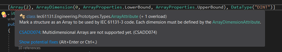

Actually I’m not sure that multi-dimensional arrays will work. It is possible to declare multi-dimensional arrays in PLCnext Engineer, but I suspect that the type definitions for multi-dimensional arrays generated by the C# project are not recognised by PLCnext Engineer. I will check this.
OK, I was wrong about multi-dimensional arrays. They are not supported (yet) as parameters on C# functions or function blocks.
PLCnext_CLI_CSharp_CodeAnalyzer/Rules/CSADD074.md at main · PLCnext/PLCnext_CLI_CSharp_CodeAnalyzer PLCnext toolchain code analyzer for C# projects . Contribute to PLCnext/PLCnext_CLI_CSharp_CodeAnalyzer development by creating an account on GitHub.

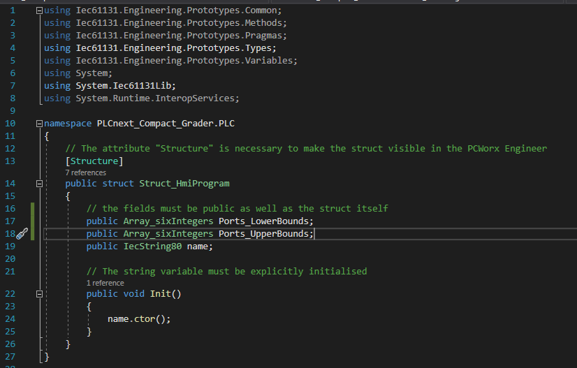

FunctionBlock1.txtSomething like this should work.
It’s a function block with an Input parameter of type “Array of Struct”, where the struct contains two DINT arrays and a STRING field.
FunctionBlock1.txt

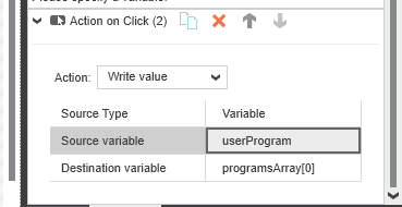

When the user presses a button I want userProgram to be copied to programsArray[0] from the Hmi, but when I do this:

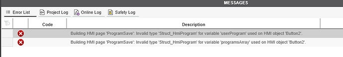

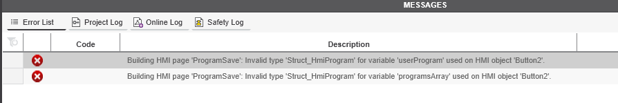

I get the error:

Here is also a screenshot of my Struct:
This latest question is not related to the C# variable definitions - it also happens in pure IEC code. You can show this by defining a simple STRUCT type in PLCnext Engineer, declaring two variables of that type, and trying to use the “Write value” action to copy the value of one variable to another. This also doesn’t work, so this is a missing feature of the HMI, not a problem with the C# code.
A work-around for this missing feature is for the button on the HMI to set a flag in the PLC which triggers an assignment operation in an IEC program instance.
