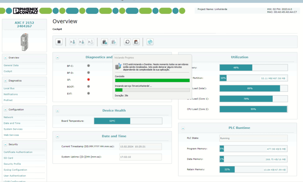

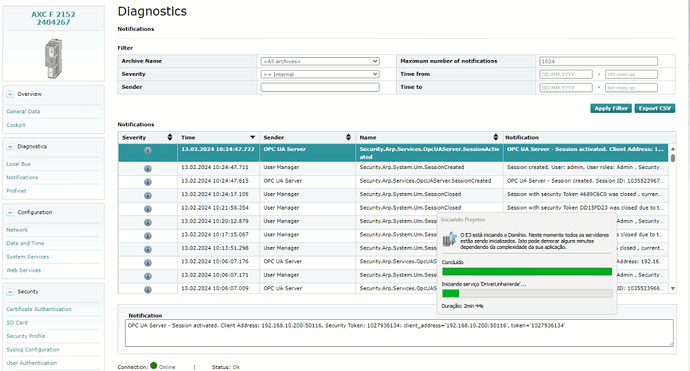

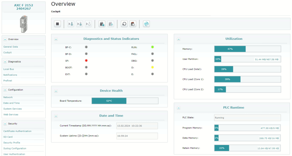

I am connecting the AXC 2152F with the Elipse E3 (HMI) via OPC UA.
Every time I attempt to import tags into Elipse E3, the PLC operates at 100% processing capacity, leading to frequent resets.
Additionally, when I launch the Elipse E3 application, the PLC remains at 100% processing capacity.
