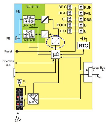

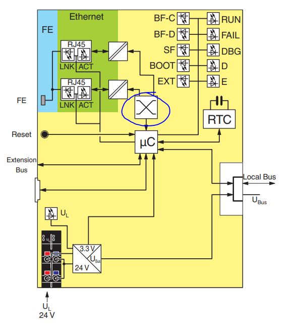

The two ethernet ports of the AXCF 1152 are switched internatlly:
Is there a way to configure the switch either by the OS/firmware or driver settings?
That’s an unmanaged switch, so there isn’t much configuration to do.
What did you have in mind?

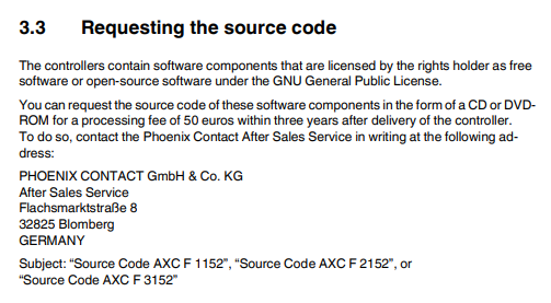

You can build your own custom version of the kernel using the procedure described here:
https://www.plcnext-community.net/makersblog/howto-build-a-new-kernel-for-the-axc-f-2152-fw-2019-0/
… however you will need to request the kernel sources using the process described in the User Manual:
