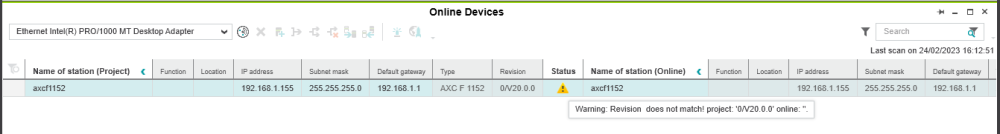

I’m trying to use an AXC F 2152 as PN Controller and AXC F 1152 as PN Device, with no success.
Both devices are running FW 2022.0.4.
I’m using PLCNE 2023.0
I have imported the GSDML file for AXC F 1152 (GSDML-V2.32-Phoenix Contact AXC F 1152 -V1.0-20191211.xml) and I can see the device online, but after adding the device to the project, this is what I get:
I also tried to make opposite test, using AXC F 1152 as PN Controller and AXC F 2152 as PN Device, without any problem (I used GSDML-V2.35-Phoenix Contact AXC F 2152-V1.0-20210811.xml).
Maybe the GSDML for AXC F 1152 in not updated?
