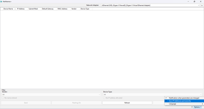

while assigning the ip address using netnames, please select the save IP addresses Permanently in options. Which is available in bottom right side in the netnames.
Or try to assign the ip address using WBM.
Hey Jayachandra, thanks for the message. I’ve tried it out and it works! Thank you very much.
