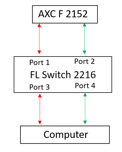

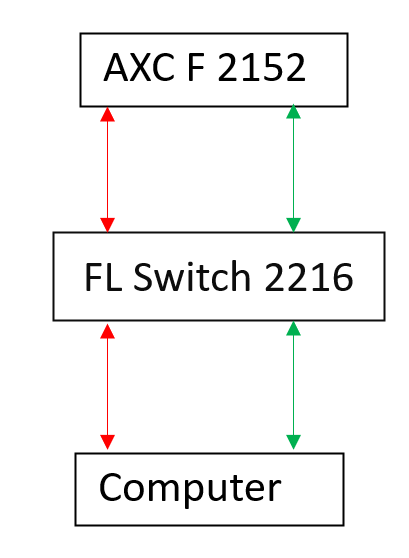

Can I connect the ethernet cable as below. If red ethernet cable is disconnected or port is down then the communication should be happen throughgreen ethernet cable. Polling the data in computer using modbus TCP/IP.
Is it possible ?

You at risk to create ring-loop in your network. LAN ports at AXCF2152 operates like tiny unmanaged switch. And if it is possible to manage port reservation on FLS 2216 (there is MRP settings on 2xxx switches, so you can play around this), than this topology can be possible. In other cases, there will be troubles.

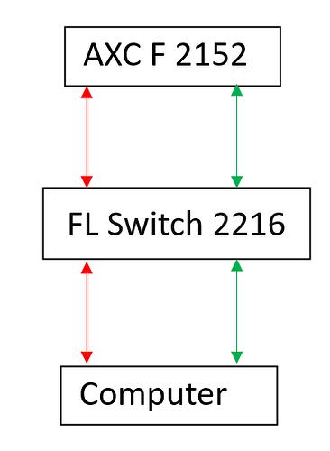

Does the FL switch 2216 supports port failover functionality (If port 1 down, communicate through port 2 and if port 3 down, communicate through port 4 like this). Is it possible to do this ?

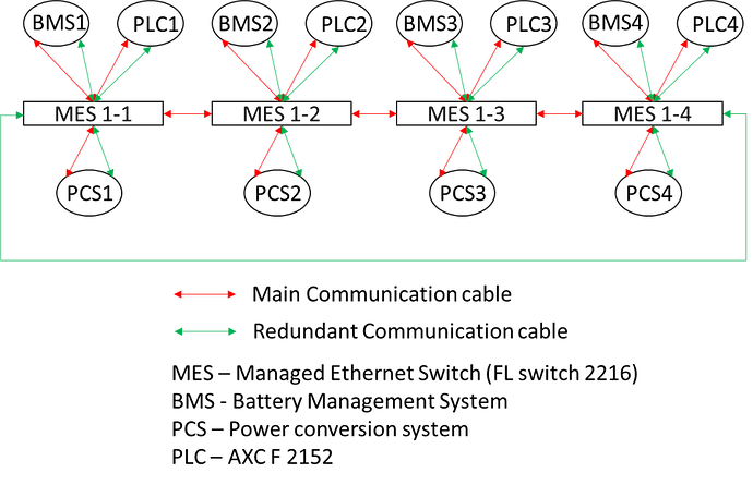

If it is possible then we have plan to use it as below.
If it is not possible, then can you please suggest how can we plan for redundancy in the network ?
It seems, that such complicated schema could not be realized with FL switch 2216. But, nevertheless, you have to receive additional consult from your local PhoenixContact department.
