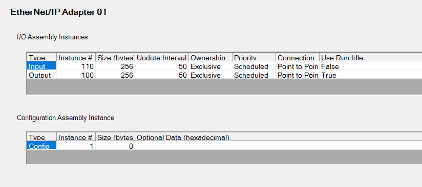

Yaskawa MPiec as Ethernet/IP scanner works. Use these settings:
Yaskawa MPiec as Ethernet/IP scanner works. Use these settings:</p>[https://forum.plcnext-community.net/uploads/2829R43GA22R/image.png</a></p>
Thanks, parameters it’s ok. Question about somebody try connect to devices? Because if we use one devise(Siemens or Yaskawa) connection work, but if connect two device connection down.
