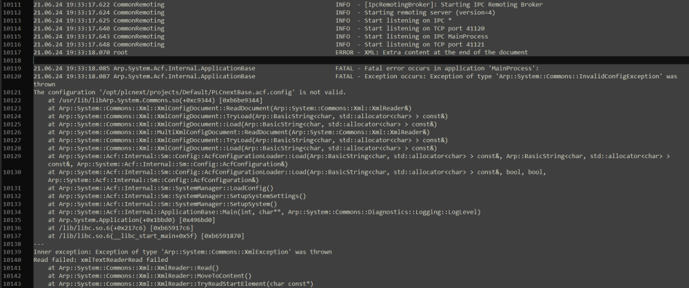

I apologize for not replying earlier, we proceeded with a type 1 reset and were able to restore the PLC to a functioning state, I attached the log files in the linked zip file and added an image showing the error pointed out by our supplier.
https://files.catbox.moe/1t8hl4.zip
Given that the Diagnostics LED was on, we believe it has something to do with the connection to the local bus modules but we can’t confirm the actual cause.
I can’t download the .zip file (the linkt will be blocked by our network security). But I can see in Screenshot, that the cause of error is the not valid configuration in “PLCnextBase.acf.config” file (it can be a follow up error).
Please also see the Line 10118 in Screenshot, I assume this line contents the “NULL” (Please verify the content in Notepad++). If I’m right, the problem can be the old FW or the malformed SD-Card (internal or external).
