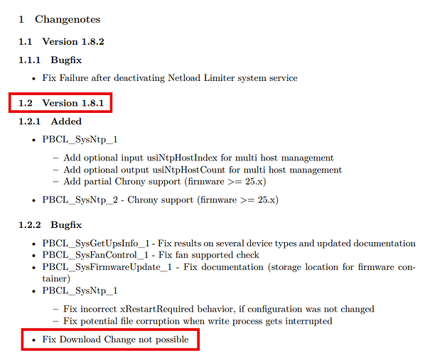

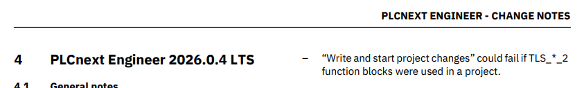

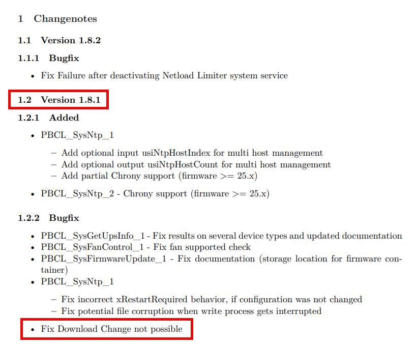

That looks like the symptoms of a problem that was fixed in PLCnext Engineer 2026.0.4 LTS and in the PLCnextBase Library version 1.8.1:
From the PLCnext Engineer change notes (in the “Fixed errors“ section):
From the PLCnextBase library change notes:
I changed the PLCNextBase library to 1.8.2.

The problem is probably caused by the version of PLCnext Engineer, not the firmware version. I have just discovered that PLCnext Engineer version 2026.0.4 LTS is not yet available on the Phoenix Contact website, but it should be available there in the coming days.
Thanks, I saw already in the change notes of PLCnext Engineer that version 2026.0.4 LTS is available, I saw this in the document.
