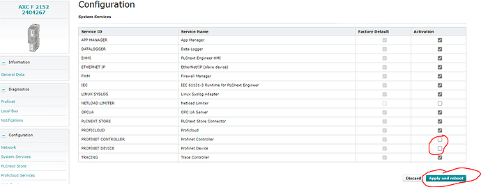

Hello Eduard, I have done the firmware update, but the BF LED is blinking all the time, I have only connected the Phoenix TP6070 Panel and I do not need any other BUS. Thanks Michael

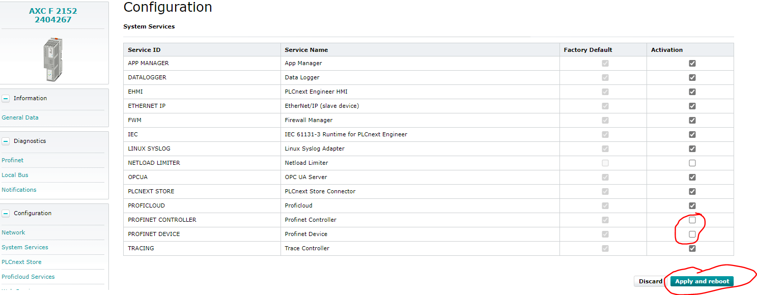

Hello Michael, I assume in your case the BF-D-LED is blinking with 1Hz. If it’s behavoir, please see the description in the User Manual “3.9 Diagnostic and status indicators”. Status of PROFINET communication: Link status present, no communication connection to the PROFINET controller Please note, the Phoenix TP6070 Panel is not the PN-Device and don’t supports the PN-Communication. You can deactivate the PN-Controller and Device functionality via WEB-Interface to deactivate the PN-Component and PN-Status-LED’s (see attached Screenshot). Please note after PN-Deactivation it is not possible to change the IP-Address via DCP (e.g. in Tools: PLCnext Engineer or NetNames+) Best Regards Eduard
