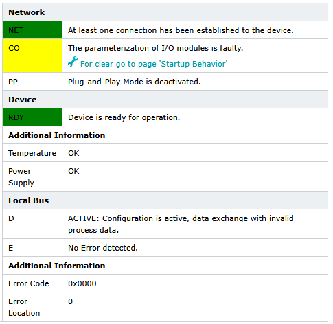

i am trying to configure my AXL F BK ETH (FW 1.32) to be controlled via Modbus TCP.
I have disabled the Plug and Play Mode but the config did not get saved. I always get the message that the Bus config has changed:
If i then use the password and clear button its gets ACK but nothing happens, the message stays.
I tried to:
-Reset the controller to factory default
-Enable / Disable Plug an Play mode again
-Deleted the config with WinSCP/FTP from the BK
-Used Startup+
What am i missing?
Hi Tobias,
Please reset the bus head to the factory settings using the reset button, see instructions 11.2
Then read in the local bus devices again via plug-and-play mode.
All local modules must be energized when reading in.
Only when this has been completed, carry out further settings such as IP assignment.
There is also a support ticket for the request with the number #436993, you can reach the support at 05235 311000 or Support@phoenixcontact.de.
