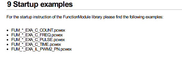

The question would be if the block is compatible with the module, since in the examples they use this IB IL CNT-PAC (2861852), I have this AXL F CNT2 INC2 XC 1F and which module would I use to have the RPM, the revolutions per minute .
Is there an example with this module AXL F CNT2 INC2 XC 1F or its similar
FunctionModules_4-20220426050301 (1).pdfIn the document there are some example blocks, can you use any of them or for the revolutions per minute part, is there any other or any recommendation to do the calculation or any block?
greetings
I’ve just checked with the developers of that library, and unfortunately the library is not designed for use with AXL F CNT2 INC2 XC 1F.
If there isn’t another suitable library in the PLCnext Store, then you will need to use the Process Data directly in the PLCnext Engineer project. The Process Data for the AXL F CNT2 INC2 XC 1F is described in detail in the User Manual for that module.
