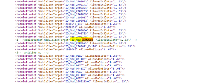

I m trying to use the AXL_F_BK_PN_TPS in TIA portal
In the module configuration I can’t found the Communication module 2702668

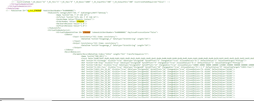

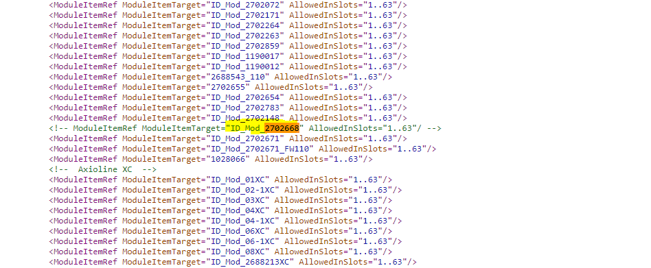

Looking inside the the GSDML file it seems like it is not used , it is putted in comment
did some one already used this communication module with tia portal ?
