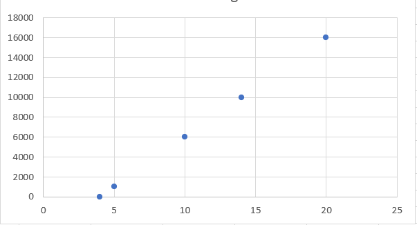

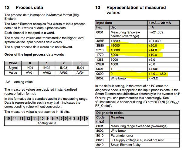

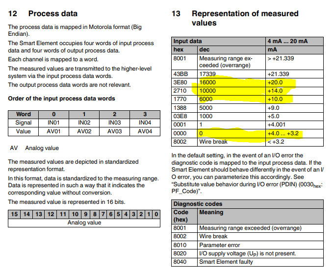

AXL SE AI4, how do I scale this card to get a linear reading? This data from the manual shows very nonlinear input. I would expect if 20mA is equal to 16000, then 10mA would be 8000. But, 8000 is used for diagnostic codes. How do I get a linear scale or how do I use this for an output that needs scaled?

Here is the short explanation:
The Range begins by 4mA = 0 Digit
4mA = 0Digit;
20mA = 16000Digit;
0,001mA = 1Digit;
Calculation:
20mA: 20mA- 4mA = 16mA
Digit: 16mA * 1Digit/0,001mA = 16000
10mA: 10mA -4mA = 6mA
Digit: 6mA * 1Digit/0,001mA = 6000
5mA: 5mA -4mA = 1mA
Digit: 1mA * 1Digit/0,001mA = 1000
Result: The Input is linear:
