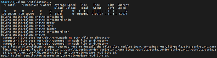

I installed the balena-engine ( https://github.com/PLCnext/Docker_GettingStarted ) in axcf 2152
When I saw img1

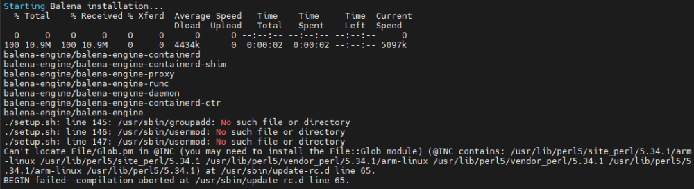

There is no problem with the installation balena-engine, but there seems to be a problem with registration of the serviceI think problem with the execution of the img2 command ( update-rc.d , usermod, groupadd )Please give me some advice.
img1)
img2)
Hello park,
I assume the failure can be in “setup.sh” script, the folder structure will be not created/founded (see errors in first screenshot).
