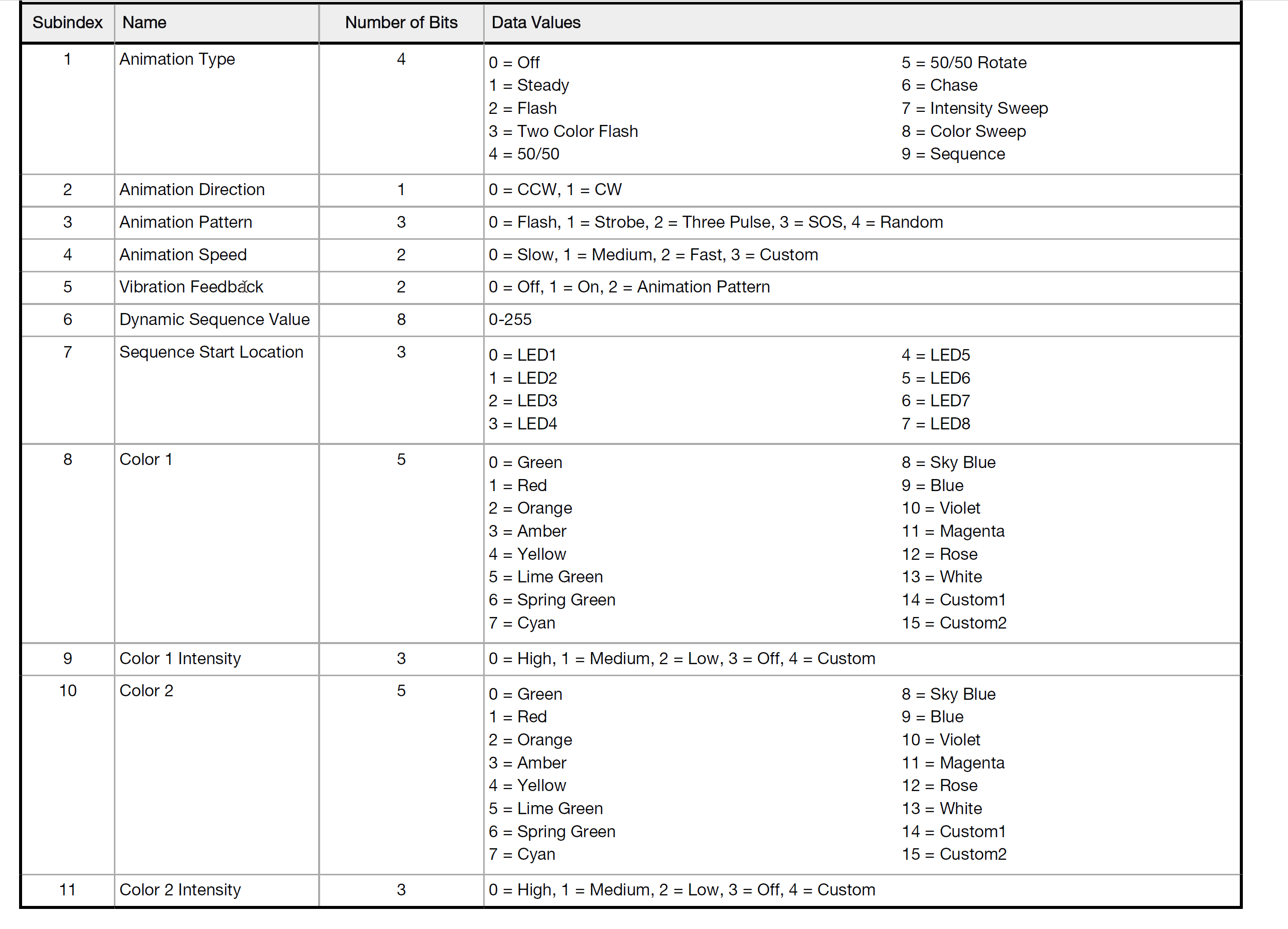

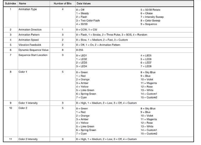

So does anyone one have a better way of simplifying creating a INT value for these buttons? I am going cross eyed figuring out the INT value every time i want to write a different color panel to these buttons. Or what is the process for making a custom function block to control these buttons. Something that could be used in may other programs. That would have the subindex (1-11) for advanced mode as separate INT input on the function block.. I have attached the Data Map PDF.. Hope someone has a better way than i do.. Thank you..

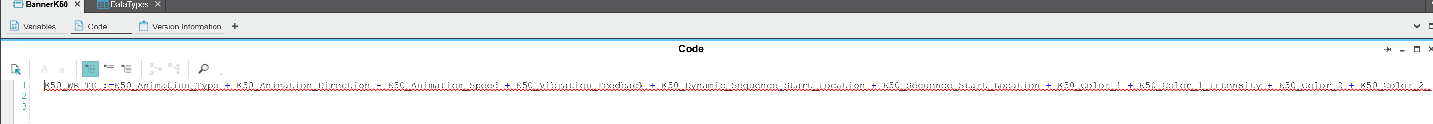

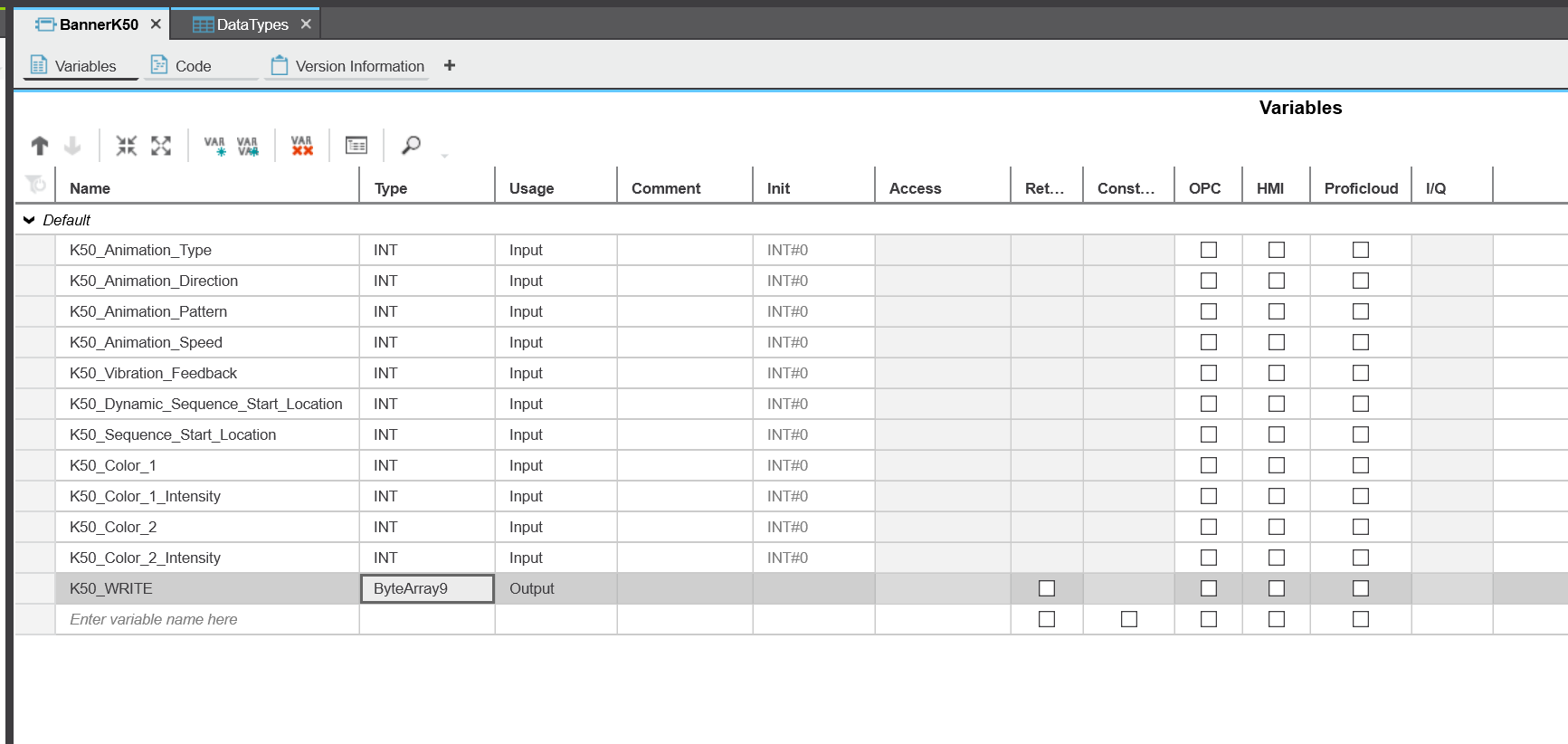

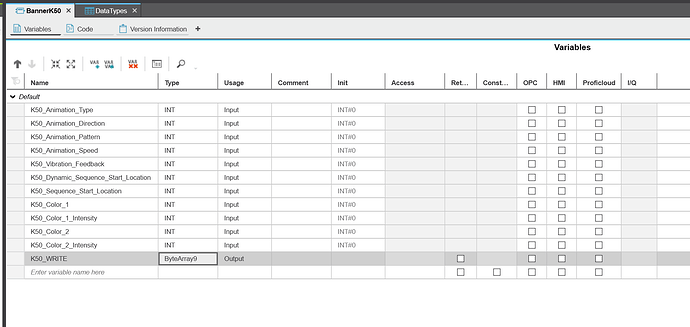

Thank you Martin for your quick response.. I did not realize creating a function block is so simple to create.. I will used this many time in the future for sure. Funny i did not know this being a long time PCWorx user.. My question now is how do you hold the Bit Spacing in the Octects for “0” Bits. I added a few screen shots of where i am at with this.. Example: Animation_Type is 4 Bits long Animation_Direction is 1 Bit long Animation_Pattern is 3 Bits Long and so on.. If each one of those init values = 1 then the output of the function block on a bit level would be “111” and not the required “00110001” Also would the 9 Octlets be a ByteArray9 if so int can not be added to bit array. Any help would be greatly appreciated..
Hi Jason, One solution is to use the bit-access operators, e.g. Animation_Type.X0 to read bit 0, and K50_WRITE[0].X0 to write bit 0 of byte 0. You can only use these operators on “ANY_BIT” variables: 2020 07 22 222002 … so you would need to change the type of your Input parameters if you want to use this operator. To see more about “Partial Access” operators, search the PLCnext Engineer help system for “Partial Access to ANY_BIT Variables”. If you are going to use Enums for the inputs, then you can define the type of the Enum to be one of the ANY_BIT types, so you can still use the partial access operators on Enums. And because ANY_BIT types come in 1, 8, 16, 32 and 64 bit widths, you can chose the smallest one for the width of the input variable. For example, you can declare Animation_Type as a BYTE, and Animation_Direction as a BOOL (or Enums of those types). Hope this helps. ~ Martin.
