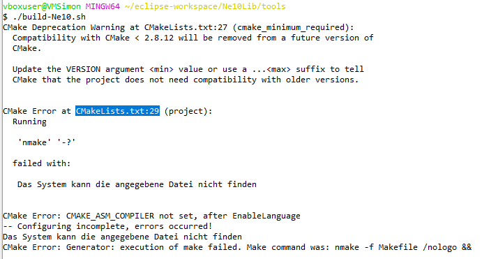

I am currently trying to implement the example where you should integrate an external open source library (Ne10) into the C++ project. My Eclipse runs on a Windows host.
CppExamples/Examples/IncludeOpenSourceLibrary/README.md at master · PLCnext/CppExamples Collection of various C++ sample code for PLCnext Technology controllers. - CppExamples/Examples/IncludeOpenSourceLibrary/README.md at master · PLCnext/CppExamples Unfortunately, I always get an error message when executing step 2 after the following command:
build-Ne10.sh
Has anyone ever had the same error and can help me?

It looks like CMake is trying to use nmake as the default generator, and it can’t find nmake on your system.
I googled the error message you saw, and this was one of the top hits:
Error while configuring CMake project: Running ‘nmake’ ‘-?’ failed I 'm following this tutorial for building GLFW on Windows, and I’m getting the error when running cmake -S . -B Build:\nPS ~\glfw-3.3.2\GLFW> cmake -S . -B Build\nCMake Error at CMakeLists.txt:3 (p… You could try the solution mentioned there, i.e. add -G "MinGW Makefiles" to the cmake command in the build script.
It looks like CMake is trying to use nmake<\/code> as the default [generator<\/a>, and it can't find nmake on your system.<\/p>I googled the error message you saw, and this was one of the top hits:<\/p>[https:\/\/stackoverflow.com\/questions\/69338088\/error-while-configuring-cmake-project-running-nmake-failed<\/a><\/p>You could try the solution mentioned there, i.e. add -G “MinGW Makefiles”</code> to the `cmake</code> command in the build script.</p>

The suggestion unfortunately didn’t work. I had to add the “nmake.exe” to the enviroment path:
C:\Program Files\Microsoft Visual Studio\2022\Community\VC\Tools\MSVC\14.36.32532\bin\Hostx64\x64
In order to do that i first had to install Visual Studio Code since the “nmake.exe” is part of the VS.
Unfortnuately after solving this error i had another one:
(Link target) →
LINK : fatal error LNK1104: Datei “kernel32.lib” kann nicht geöffnet werde
n. [C:\Users\vboxuser\eclipse-workspace\MyProject\build\axcf2152\external\Ne10\C
MakeFiles\CMakeScratch\TryCompile-1nk6eb\cmTC_1c5e7.vcxproj]
5 Warning(s)
1 Error(s)
The mentioned path in the error doesn’t even exist… CMakeScratch is just an empty folder.
image.pngIs it normal to have so much trouble or is this example just a bit to ambitious for me?!?

The example uses a Linux host to build NE10. The bash script is only an example, which might need to be modified, especially if you’re using Windows. It might be possible to build NE10 on Windows, but we haven’t tried it.
The build instructions for NE10 don’t mention Windows:
Ne10/doc/building.md at master · projectNe10/Ne10 An open optimized software library project for the ARM® Architecture - Ne10/doc/building.md at master · projectNe10/Ne10 In this case it is probably simpler to just switch to a Linux machine to build NE10 (e.g. a Linux virtual machine running on Windows). If you can get that working then at least that’s a success you can build on.
