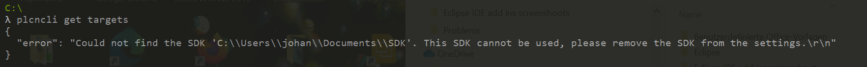

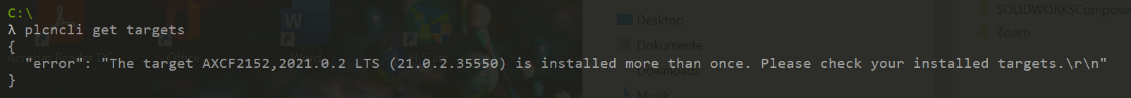

Thanks for the quick reply, The first message is the one in screenshot 1. If I drag the SDK folder one directory in front of it, the message from screeshot 2 appears. After the report in the community, I have currently also tried the previous Eclipse versions and unfortunately also failed. best regards PLCNextStarter
Hello plcnextstarter, 1. please verify the Target entries in following file and delete the target listed twice: C:\\Users\\YourUserName\\AppData\\Roaming\\plcncli\\settings.xml 2. Please also verify the Target Name ( “AXCF2152” ) in following setting File and correct it, if needed: C:\\Users\\YourUserName\\AppData\\Roaming\\plcncli\\sdk-properties.xml e.g. the following line is included if the SDK 2021.0.0 LTS (21.0.0.35466) is installed : If the settings are corrected, please execute the command “plcncli get targets” again. Thanks & Best Regards Eduard
Hello plcnextstarter, As discussed during the remote session, the cause of the error was the deletion of the SDK directory. In this case the plcncli tool tries to access this (deleted) directory and cannot find it. The solution is to remove the SDK in plcncli before deleting the SDK folder (please see the related How-To in Attachment). Best Regards Eduard
