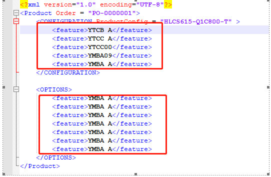

I’m using the tinyxml library, and I’m reading out the data in the XML file, and the GetText () output is (const char* type). The information in the red box in the XML file has been taken out by GetText. I want to package the data in the red box into an array and send it to the PLC.Please see the attachment for the picture const char* node1Name = xmlNode1_Name->GetText(); cout << node1Name << endl; TiXmlElement* brother = xmlNode1_Name->NextSiblingElement(); TiXmlElement* brother = xmlNode1_Name->NextSiblingElement(); while (brother)while (brother) { cout << brother->GetText() << endl; brother = brother->NextSiblingElement(); }

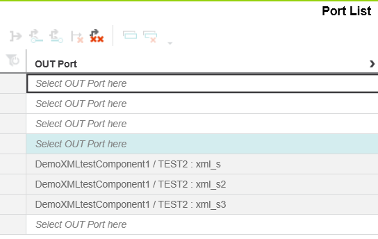

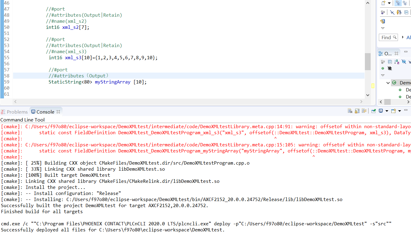

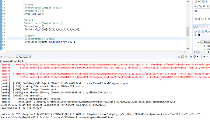

I wrote it your way and compiled it correctly, but I had no interface output on the PLCnext side
The PLCnext interface has no exclipe string output
Hello Lixin, was the library in the engineer sucessfully replaced after rebuilding it?
Does rebuilding the Project help?
It should look like this.
You can Notice at the Type if you are using a old “plcncli” tool or eclipse plugin.
WRONG:
staticString Correct: staticString correct you can also Disable the Filters in the ProjectExplorer in eclipse and have a look at the intermeddiat/config/PROJECT.typemeta or intermeddiat/config/COMPONENT/PROGRAM/PROGRAM.progmeta Make sure you have the 2020.0 PLCnCLI installed.
After changing versions restart eclipse.
