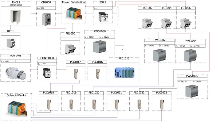

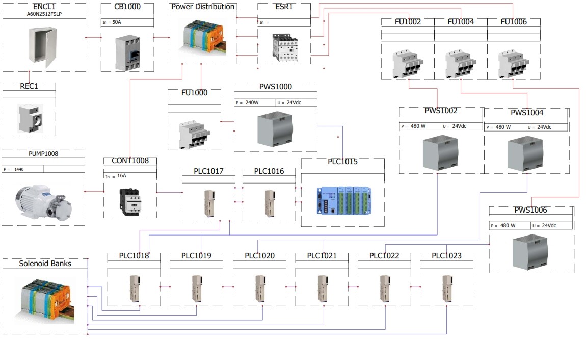

So when we run program to run on all outputs then close again after 100ms then repeats this process everthing seems to work fine(one problem with this program is that it doesnt open and close on consitent intervals but I will ask about this in another thread). This program is made through stuctured text and not the C++ route but when we run the C++ program the same thing ends up happening again do you still think this a power problem or could it be the programming and setting up of the project. Though attached or some schematics on how we set everything up The diagram shows the old plc we are now using a plcnext controller
