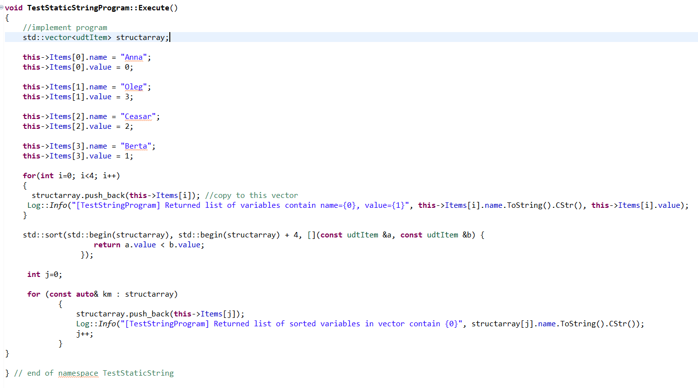

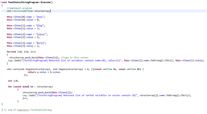

I’m facing a strange issue after moving from array of uint8 to StaticString<>.
1. I had a C++ program using array of uint8 for sharing strings between C++ and IEC61131 program.
2. Those "strings" were members of a struct.
3. I used an array of those structs.
4. I used std::sort() to order the structs by a numerical member.
Example:
// struct definition
struct udtItem {
uint8 name[8] = { 0 };
int32 value = 0;
// array declaration
udtItem Items[300];
code that fills the members of the structs
member .name could be empty
// sorting code
std::sort(std::begin(Items), std::begin(Items) + 300, [](const udtItem &a, const udtItem &b) {
return a.value < b.value;
Everything worked correctly.
Then, I decided to move from array of uint8 to StaticString<>.
struct udtItem {
StaticString<8> name = ""; //uint8 name[8] = { 0 };
int32 index = 0;
Using std::sort() this time creates a bad error: All the StaticStrings that were empty before the sorting are filled with random values (it seems that are filled with the content of the same member from other structs of the array) Is this an expected behavior? Thanks, Marcello
