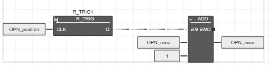

CTU is good enough, but it’s limited to INT datatype values range -32768..32767 for PV and CV, and if your process is intensive, CTU can easely go to overflow… Use R_TRIG/F_TRIG with INC UDINT/ULINT to solve the problem.
Perfect we thought in the exact same way! I used a TP to activate the ADD only that I noticed that every time I download the software you add a +1. I try with your R-trig , obviously OPN_position will have to be retain right?
OPN_accu have to be retain. Other don’t

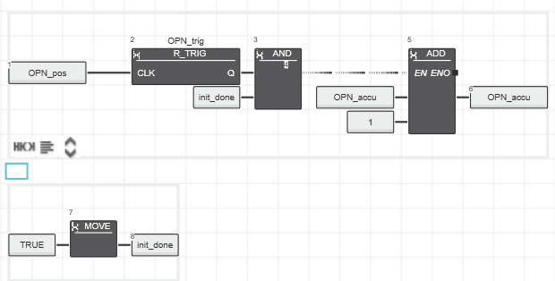

To avoid inc during startup, I think you can use first cycle trigger. Variable init_done with false startup value. It will allow to skip this issue.
I tried but it does not always work, I opted for n TON with delay 1Sec now works fine!
