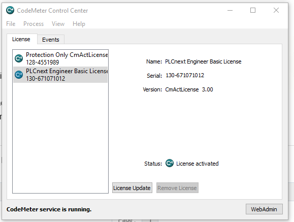

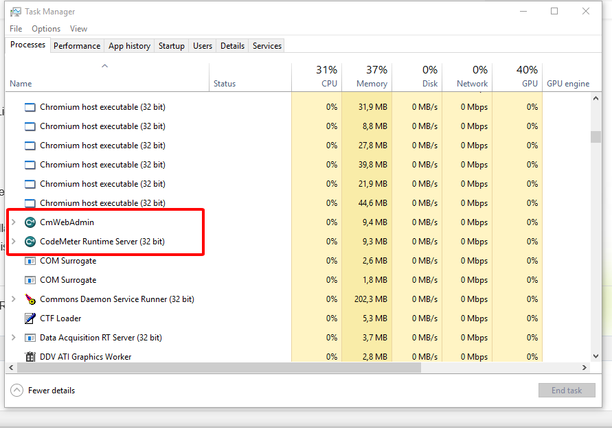

Dear Mr.Oliver, I sure that all services of CodeMeter is running when I start PLCnext Engineer, please see attached pictures. CodeMeter Runtimer Server
CodeMeter WebAdmin
Code Meter Controll Center , and see a “PLCnext Engineer Basic License”. I installed this software in Administrator right. But Error100 is still raise after start about 5 minutes. How can I resolve this Error ? ---------- DNA

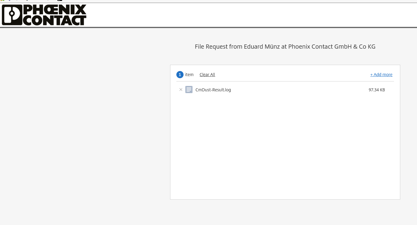

Hello DNA, for more information , the devellopment need an “CmDust-Result.log” Log file. To get the log file start CmDust . You find it under start/CodeMeter/CmDust or use windows search (CmDust).The create log file have to be send back. https://wiki.tuflow.com/index.php?title=WIBU_create_cmDust Please send me the Log-File via following Link: https://phoenixcontact.sharefile.eu/r-r57827929bdd45ee9 Thanks & Best Regards Eduard
Hello Eduard, I sent the “CmDust-Result.log” Log file via following Link: https://phoenixcontact.sharefile.eu/r-r57827929bdd45ee9 Please check and help me. --------------------------------- Regards, DNA.

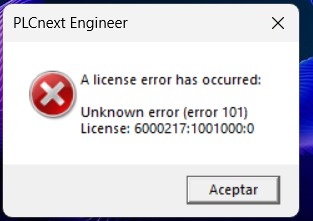

Dear Eduard i have this problem whit i try to install plcnext
please con you help me
