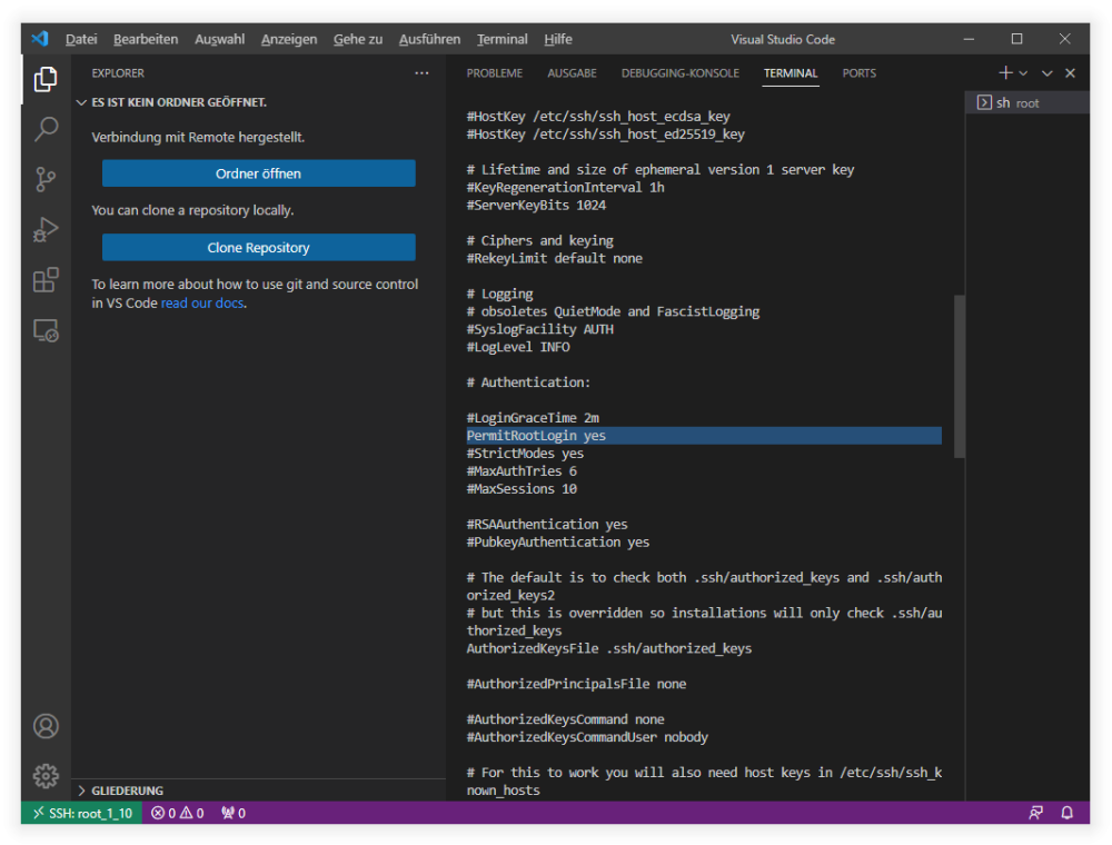

I enabled Root access for SSH, and it works like a charm. I can log-in to the device via SSH as Root:

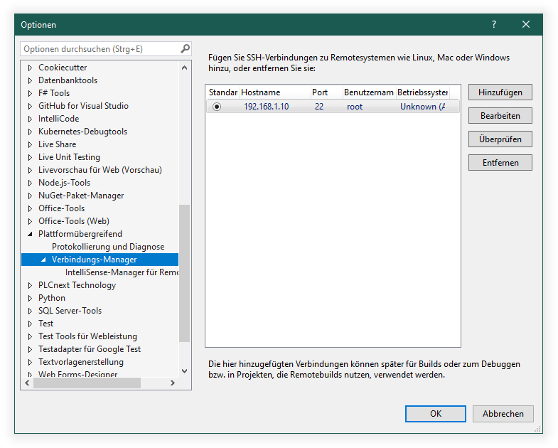

Then, in Visual Studio 2019, I added a corresponding SSH account:

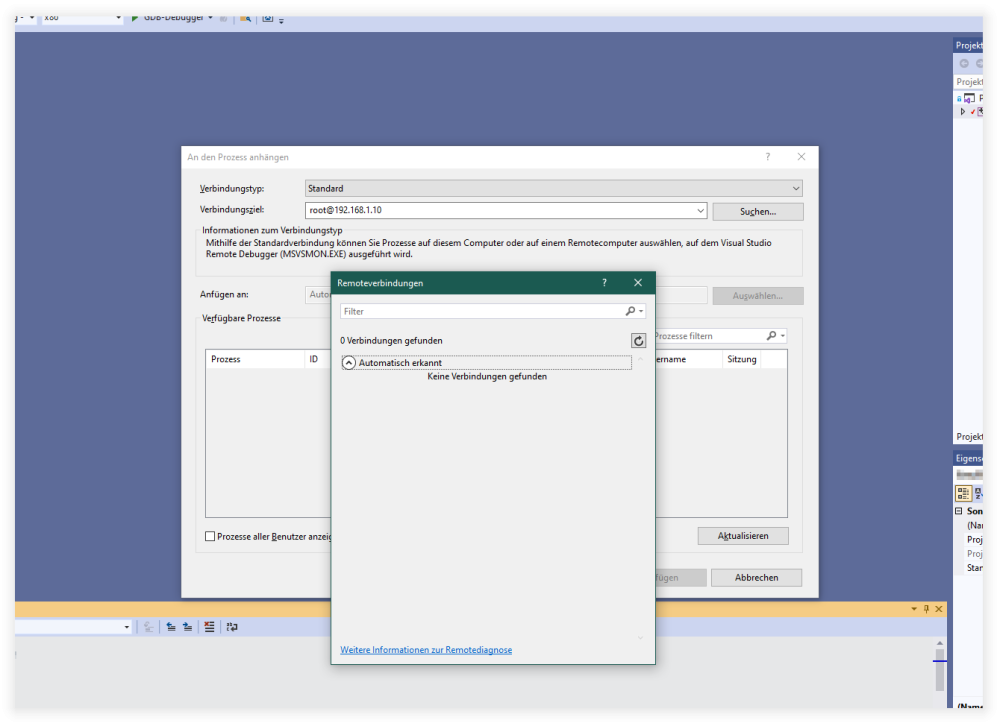

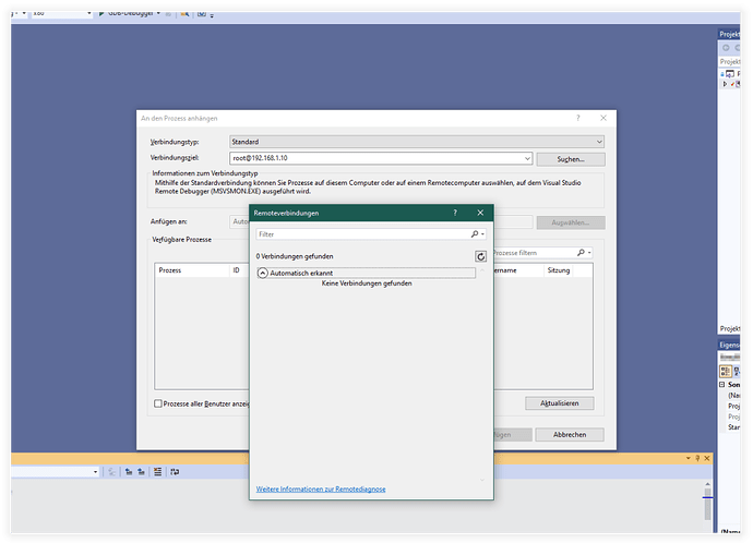

However, I’m not able to attach to the device’s remote debugger from within Visual Studio 2019. The device is not being found:
What am I doing wrong here?
