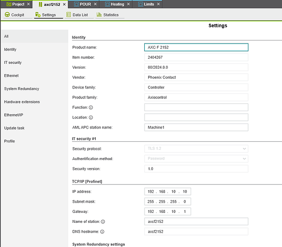

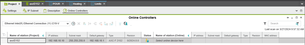

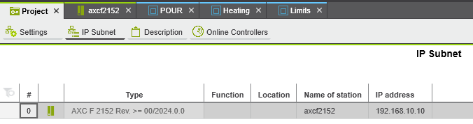

Hi Martin, Thank you for your reply. The ‘run’ and ‘D’ led are both green, ‘BF-D’ is flashing red. I have tried both methods from the Help quickstart. I can’t seem to edit the IP address in the ‘Online devices’ tab, see below picture. Untitled picture The offline methode also doesnt work, since the IP I want to give the PLC is outside the standard range. When I change the range on the project page I can’t access the PLC anymore.
OK, so that screen shot looks good. You can change the range of valid IP addresses in the main “Project” page - just select the “Settings” tab you can see in the screen shot above. After setting the address range to a range that suits you, change the IP address of the PLC in the project. Then, you can transfer the offline IP address information to the online PLC, from the window in your screen shot above. When you press the Search button in the “Online Controllers” tab, the PLC will appear with the “old” address details.
Not quite sure why, but this somehow worked now! So thank you :slight_smile: Kind regards, Jorn
