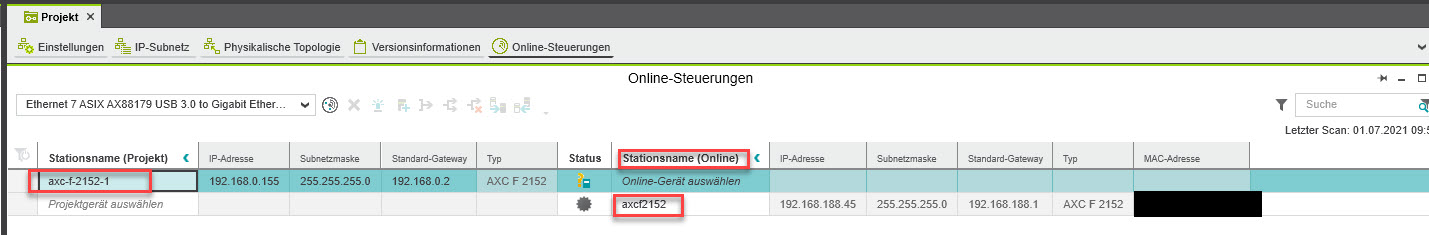

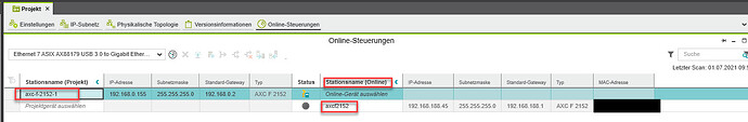

Hello Doublec4, not realy … all that realy matters should be the Online Profinet Nam AXC-1152 == AXC-1152Project PN Device name At the Project node you can you can scan for Devices. That is where you can make sure that the Online PN Name of the AXC 1152 fits the name you have defined in the AXC f 2152 Project. [attachment]PNSearch.jpg[/attachment] Also make sure that no other device in your network has the IP of the AXC F1152!

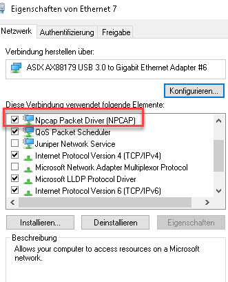

Hello, about the side Question: Either one device is setup to get the IP via DHCP or it probly has something to do with the order of starting up the devices and the handshaking of Connection Speeds. If you have trouble with the Scan for device → please check your network adaptersettings it should look like similar to this.. [attachment]npcacp.jpg[/attachment] [attachment]linklayer.jpg[/attachment] If this is activated and you are still having issues try reinstalling the Engineer or npcap drivers. You can check or change the PN name manually by logging into the PLC via SSH: /opt/plcnext/config/Io/PnS/PnS.local.config name=“StationName” No special characters allowed. No Capital letters allowed.

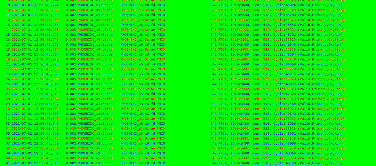

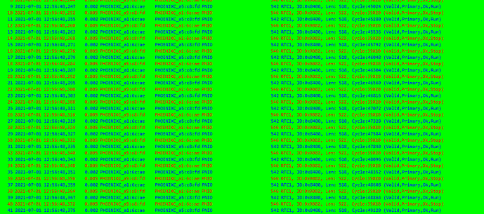

I have exactly the same problem. I’m in contact with the Dutch department of Phoenix and have had a look with them in wireshark files I created. There are a big amount of start-stops: see attachment… The problem is solved by simply connecting all profinet devices directly to eachother, as Martin is suggesting above. This will not be possible because the installation has 4 slaves and a master that are quite far from eachother in distance and all the ethernet cables are designed to go to the controlbox of the master. So from the master, the cable will run into a switch to connect everything.
Interesting, my settings are the same however I do not have the GW DEVICE SERVER NDIS Protocol. Not sure what that is, but it is not on my list.
The GW DEVICE SERVER NDIS Protocol is not required in this case (I know, that’s not very clear from the image). Arne makes a good point - if you can get in touch with your local Phoenix Contact subsidiary, then their technical specialists may be able to help with your specific setup. They might even be able to visit your office (restrictions permitting) and spot something that we haven’t thought of.
