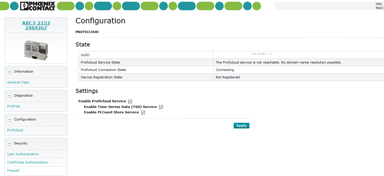

Hello, In the Web Based Management (WBM) console, can you please check that you have Proficloud enabled, and the “Proficloud TSD” check box is ticked, and the PLC is Online to the Proficloud? Martin.
Hi, it’s been a while since I opened this question. So that must be the problem, how do I connect the PLC to the Proficloud? (The PLC is connected via LAN to an internet modem).
Hi, please check:
* the IP address of the PLC is in the same subnet as the IP address of the internet modem, and * the Gateway address in the PLC is set to the IP address of the internet modem.~ Martin.
Thanks Martin. The Proficloud is now reachable. Now I have to deregister this device. How long does it take to do so?
