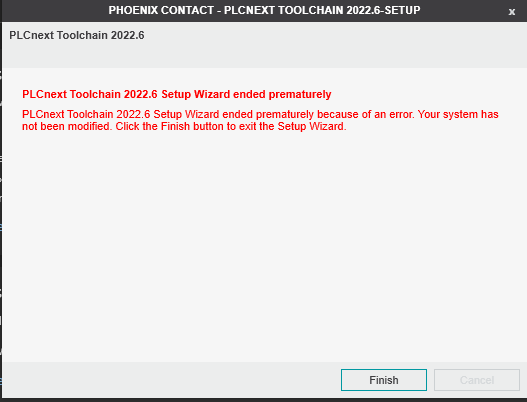

Hello Team,
I am facing the same issue, I have Visual studio community edition 2019 installed in my Windows 10 Pro PC, PLCnext Engineer software(2023.3 version) is also installed, when I installed the PLCnext_Toolchain_Windows_2022.6, I faced the same problem as image below,
Please help to rectify the problem..

                                    Thanks for the update and prompt reply,,
                                    I have tried with _PLCnext_Toolchain_Windows_2022.0_ and _PLCnext_Toolchain_Windows_2022.6,_ the result was the same,
                                    Below is the SHA checksum for the same.
                                    [image.png](https:\\/\\/forum.plcnext-community.net\\/uploads\\/24TJMTXRRJYP\\/image.png)
I have also downloaded the toolchain 2022.6 three times and try to install it, but the same error faced.
Is there any other cause of this error.

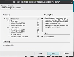

Hello Maltar,
today the new “PLCnext_Toolchain_Windows_2023.0.exe” was released and published. I successfully downloaded and installed it on my Win64 OS. Could you try to install this version, please? AXC F 2152 - Steuerung - 2404267 | Phoenix Contact
                                    [image.png](https:\\/\\/forum.plcnext-community.net\\/uploads\\/0GATA2601NAX\\/image.png)BR Eduard
Hi Eduard,
I tried the 2023 version and was able to install the extension for the Visual studio 2022 version. Thank you for your help.
Best regards.

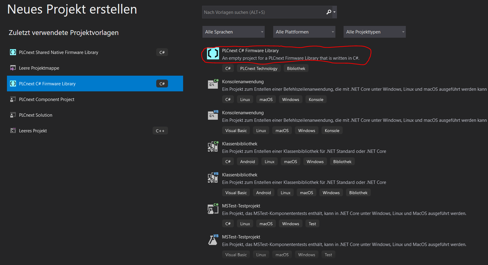

Hello, I have installed the 2023 version of the tool chain, but I am not able to see that extension in the Visual studio,
Please share the step by step process of installing tool chain,
Hello DK,
do you have selected the extension for the Visual Studio during installation?
After installation and restart of VS you should be able create the new projects by using PLCnext Template:
