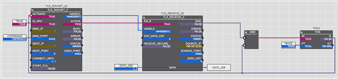

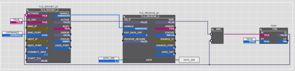

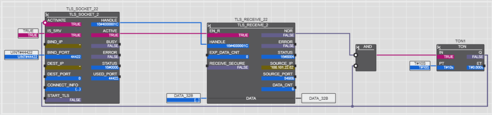

Hello!
If you use NDR output of TLS_RECEIVE_2 fb, that bind to TLS_SOCKET_2, you can detect moment of new data portion arrived. And use additional timer or etc mechanism to determine time gap between data portions. Than add some steps to catch time limit and provide necessary steps to deal with it.
Here is one of the simplest variants
BR
But it seems that there is some unresolved issue with socket maintenance in case of physical wire unplugged.
Some unexpected behavior show MB_TCP server too. And it also based on tls_socket fb in under hood…
