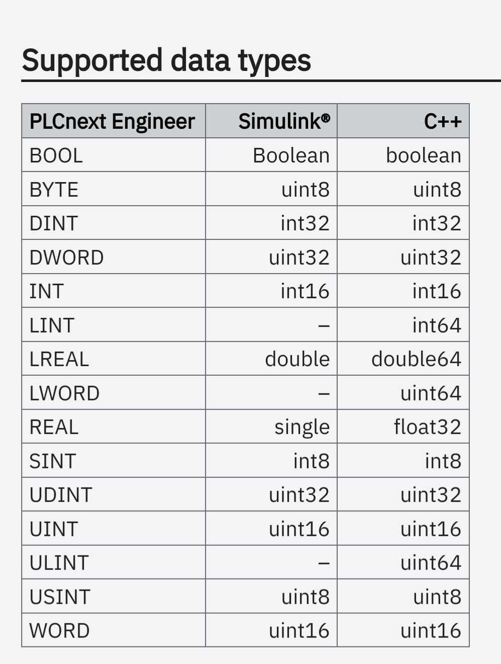

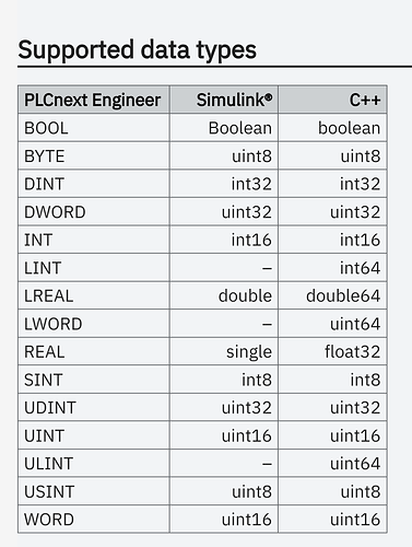

Hi Coen, a .NET String is not usable as in or output, you have to use IecString80 or define your own IecString with a different size as in the example on GitHub. https://github.com/PLCnext/CSharpExamples/blob/master/PLCnext_CSharpExamples/05_IECString/FBWithString.cs Here is a list of datatypes supported directly as in-/outputs or where you have to add an attribute. IecString80 is a predefined System.Iec61131Lib.IecStringEx with a length of 80.
https://www.plcnext.help/te/Programming/Csharp/Csharp_Supported_data_types.htm - Marcel

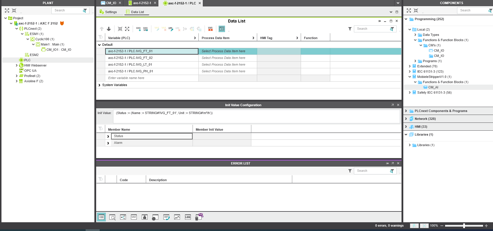

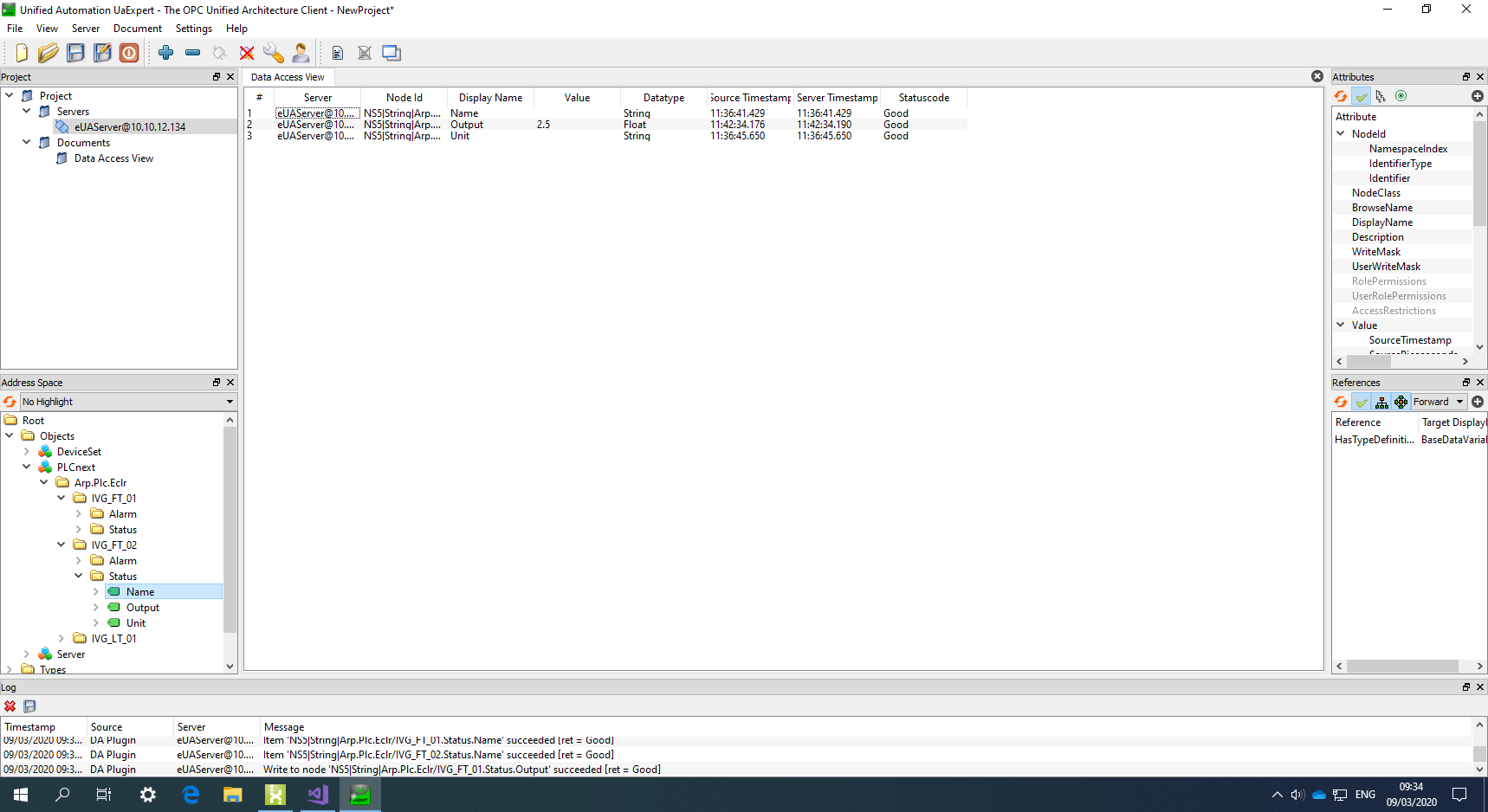

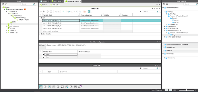

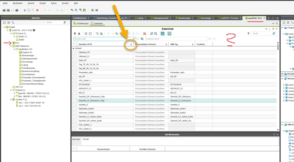

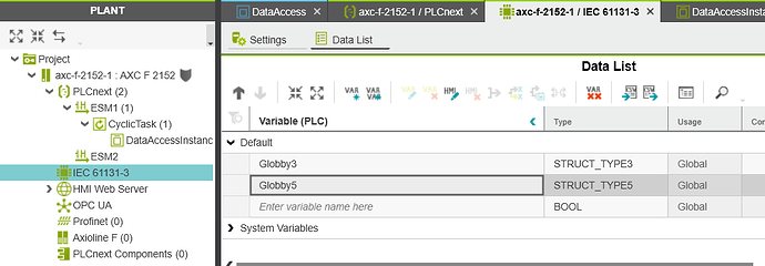

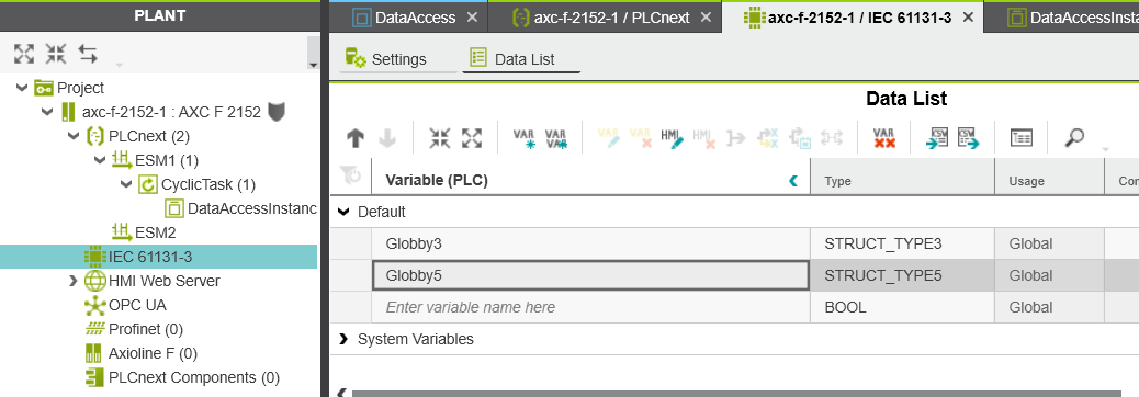

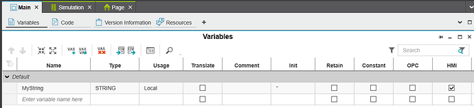

For now i tried giving the External Variables initial values in the PLC variables, where all external values show. I have given certain parameters of my data type values, so for example two strings ‘Name’ and ‘Unit’ have a initial string value.(Screenshot 1)
When starting the project these values don’t show and the strings remain empty. It does work for any other data type, for example the initial value for a Real does show. For now im looking at the variables over OPC UA. I can edit and read the Real variable, but the strings remain empty even when writing into the variables from the client. ~Coen
Hi Coen, Thanks for the additional information. Now I understand. I have reproduced the problem you described. Not only does the IecString80 field not take the initial value specified in PLCnext Engineer, I also cannot assign any value to this variable at runtime using the debug feature of PLCnext Engineer. I will pass this information to the PLCnext Engineer team and update this thread with their feedback. ~ Martin.

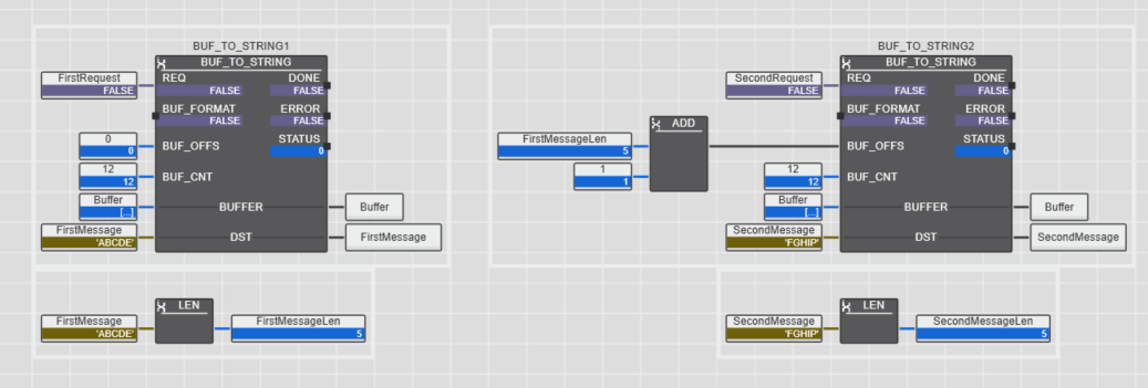

Hi Martin, I’ve run into a similar problem, which might help when trying to solve the problem. I think the issue has to do with editing strings in PLCNext Engineer vs C#. I have created an function block to illustrate this in PLCNext Engineer. The first screenshot illustrates the issue we already talked about. For some reason, i can’t edit a string i have declared in a Data Type written in C# (The AI data type). The screenshot shows the connected string to the string in the data type in debugging, but the string is not copied. The second screenshot shows the function block which did work: Connecting the string to a C# function block, which copies the string into the data type. The (temporary) solution with the C# function block is not ideal, since creating a different function block for each data type costs time and recourses.
I would prefer the first option to be working. I hope this could help with figuring out the problem. Kind regards, Coen
