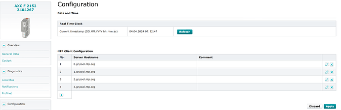

I am trying to set up ntp servers in order to have the plcnext time sync’d with Athens, Greece time.
I have this set up on the wbm page.

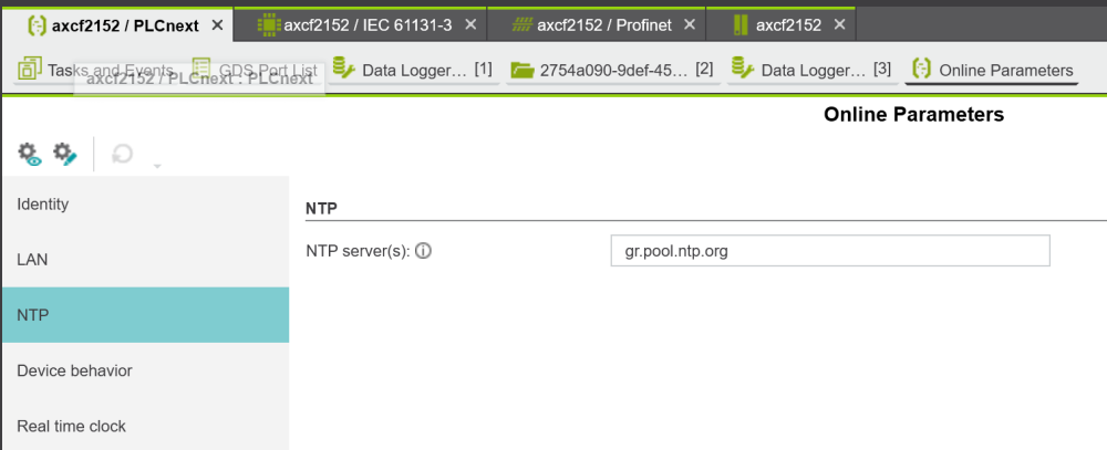

I also have this set up on PLCnext Engineer.
I have of course tried multiple reboots but still nothing.
Is there anything else I need to configure in order for the ntp servers to work?

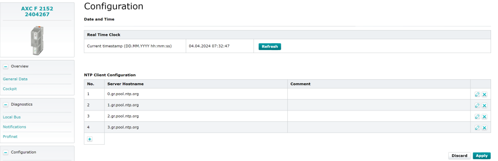

The plcnext is 3 hours behind. On the first photo the time is actually 10:32:47.

Hi!
Do you adjust your PLC timezone to EET/EEST with modification of hard link /etc/localtime?
Create a symbolic link or copy the timezone file to /etc/localtime:
Using a symbolic link:
sudo ln -sf /usr/share/zoneinfo/Europe/Athens /etc/localtime
Or, by copying the timezone file:
sudo cp /usr/share/zoneinfo/Europe/Athens /etc/localtime

I have tried pinging the external ntp servers and it works but the time was incorrect. Oleksandr solution worked for me! Thank you both!
