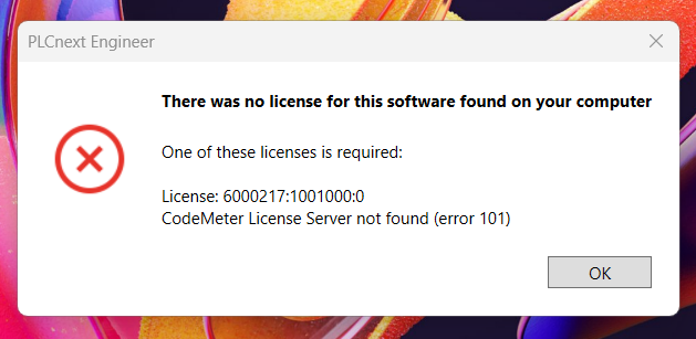

after the installation of PLCNExt VErsion 2025.0 i get the following error message - CodeMeter License Server missing Error 101
Update CodeMeter at https://www.wibu.com/us/support/user/downloads-user-software.html . Scroll down to operating system you’re using and install.
