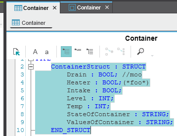

I am a big fan of user-defined datatypes and structures, hence almost all variables I use in a project is defined in a Datatype Worksheet like in the example below.
The problem is that even though I put a comment behind each variable, it is not very helpful when using the variable in the code.
For variables defined in the “variables” tab in a POU, there is a grid where scope, settings and comments can be added, and these comments are available as a tooltip when hovering the mouse over a variable in the code.
Example of tooltip with helpful info from variables declared inside a POU:image.pngExample of tooltip when hovering over a struct:Only the parent struct which is declared in the POU will have a comment, each individual child variable has no tooltipimage.pngimage.png
From other PLC developer software, such as Bachmann’s Solution Center, i am used to that the comment behind a declared variable in a typesheet is available in the tooltip. Other information such as type of variable is also there.
Lastly, i am missing a function to jump from a variable to its declared structure; I want to be able to right click on “ExampleBool2” and have a choice of "Go To Variable Declaration in Typesheet " so that i can investigate the structure and types and comments.

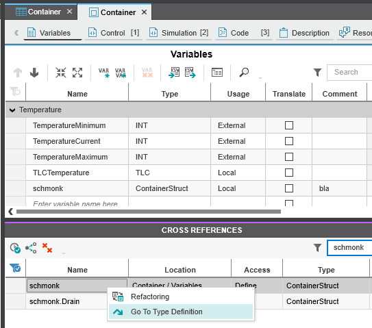

Hi fluxmodel,
the command ‘Go To Type Definition’ actually exists but only in the Cross References window.
Executing it opens the data type worksheet
It’s a little bit inconvenient to not have the command in the variable/code worksheet.
Cheers
DivisionByZero
thanks, at least that’s nice to know
