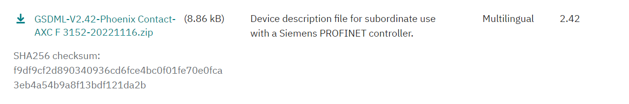

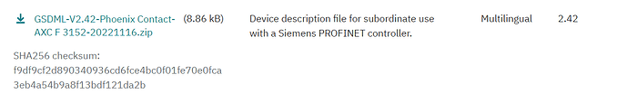

I checked the Phoenix Contact website but I couldn’t find a generic GSD file that is generic.
I was only able to find a GSDML for the Siemens controller.
I also checked the manual and it doesn’t mention anything about a GSD file available for download directly from the device.
Does anyone have an idea on where to get a GSD file for non-Siemens controller?
I don’t know why the description of this file says it’s for a Siemens controller. GSDML files should work with all Profinet controllers. Have you tried using this with the ABB controller?

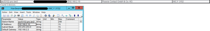

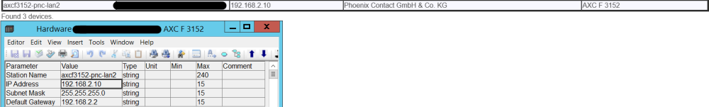

I had previously downloaded the file you share in the link and tried to integrate it into the ABB Compact Control Builder Version 6.0 and it was imported without any issues.
The ACX F 3152 is displayed in the live list but for some reason it won’t establish communication with the AC800M.
I have checked and both the station name and the IP address match the configuration in Control Builder but comms cannot be established between the too.
