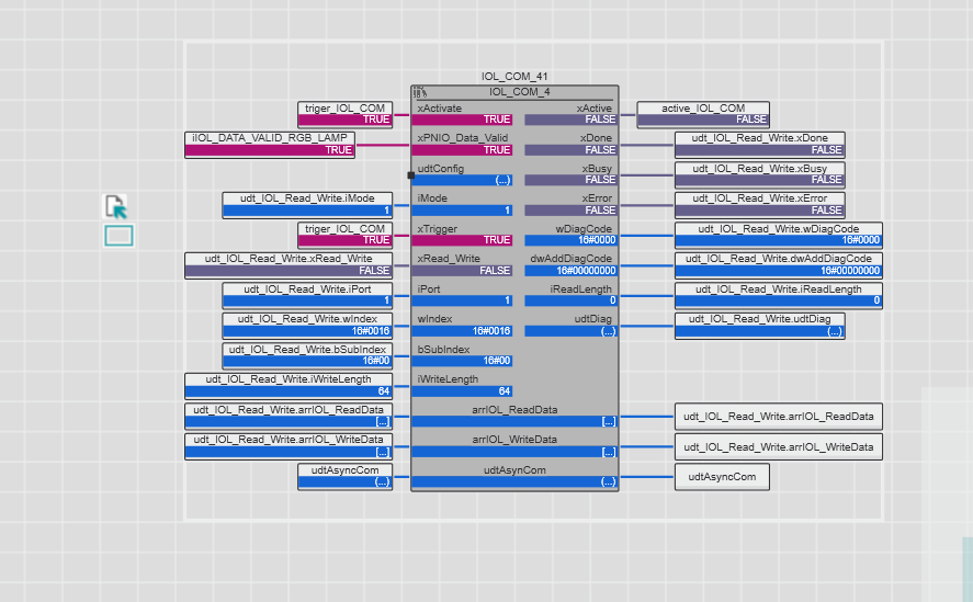

I have the same issue, I have AXC F 2152 with IFM IO-link master AL1402 with an RGB LAMP/ DV2130 from IFM. I can only reach PROFINET IO and control some of the functionality of DV2130. I tried to use IOL_COM from the IOL_BASIC library to communicate with DV2130 but I could not since the function block cannot not be active. According to the manual, this function block only works with Phoenix contact IO-Link master. I want to know if there is a possibility to use plcnext PLCs with a third-party IO-link master.
