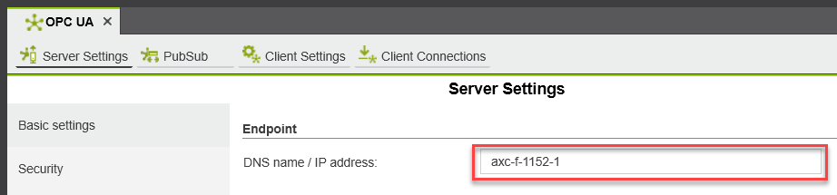

In the OPC UA server settings, does the value in the DNS name / IP address field match the DNS name or IP address that you are using to access the server from UA Expert?
image.pngThe value in this field is written into the UA Server self-signed certificate. UA clients will check this value in the certificate against the URL that was used to access the server, and if the values don’t match then either (a) an error will appear - like in UA Expert - and/or (b) the client will simply refuse to connect.
