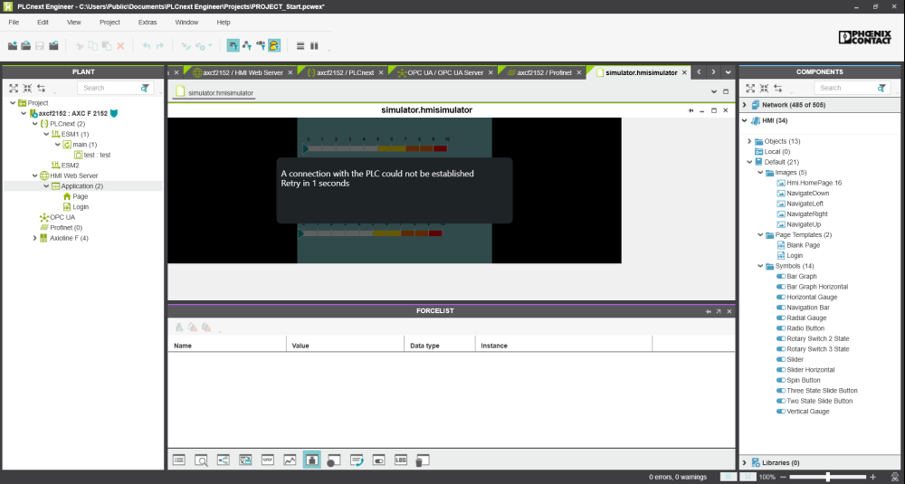

Connection with the plc could not be established
Hi, I’m having trouble loading my web hmi in both simulation mode and with a web browser. VBM is loading so I think something in my settings is wrong.

Problem Solved.
I made a factory-reset and after that my program is working.
