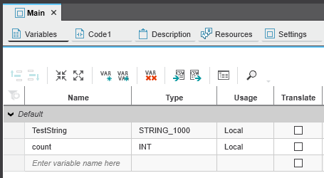

is it possible to count the characters in a user-defined string variable (e.g. ‘STRING_1000’) ?

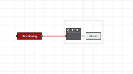

LEN() function is accepting STRING and WSTRING as input, but doesn’t seem to work with user-defined string variables.

Hello Mathias,
I have successfully recreated your use case.
Does it work for you?
Thanks for the quick response.
It was not working in my PLCnext Engineer 2025 project.
But after your post I realized that a version 2026 is already available.
It´s working fine now, thanks for the quick fix.
