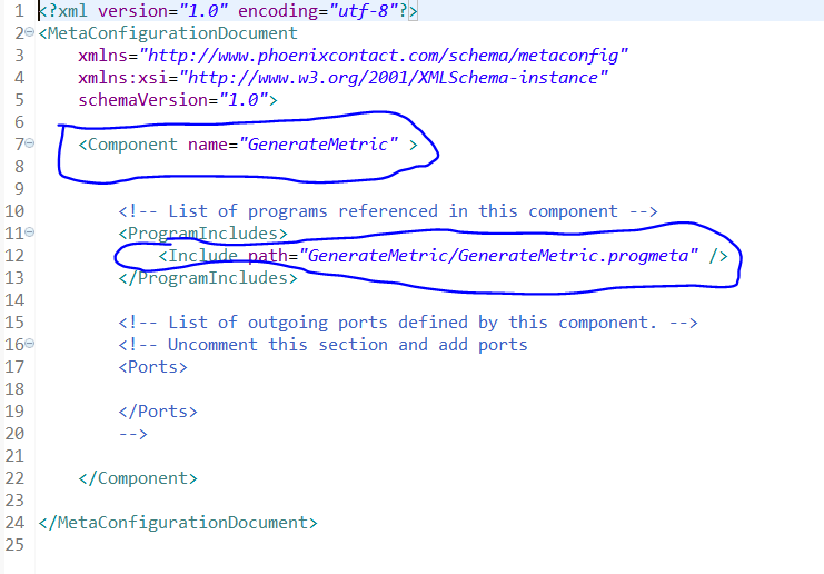

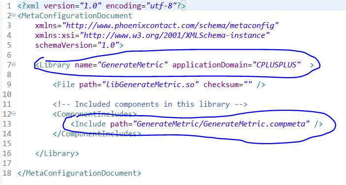

I got this error when I was first using this controller too. What was my problem was that the 'Generate Mete…" thing was being told to look for a file to parse but it was being pointed to nothing, hence, “null pointer”. (The tool is written in java I believe so that’s why it’s a java error: Fun Fact) This error popped up when I was trying to add new cpp files to the same library. Anyway, look in the the file tree in Eclipse and find the “Config” folder and keep breaking it down to the .progmeta, .compmeta and .libmeta files. Open each of those files and make sure paths & names are pointed to the right places. This link is for adding a cpp program to the same library. It works but read it carefully and take time to make sense of the pictures. https://www.plcnext-community.net/index.php?option=com_content&view;=article&id;=89:add-a-new-c-program&catid;=45&Itemid;=263⟨=en
