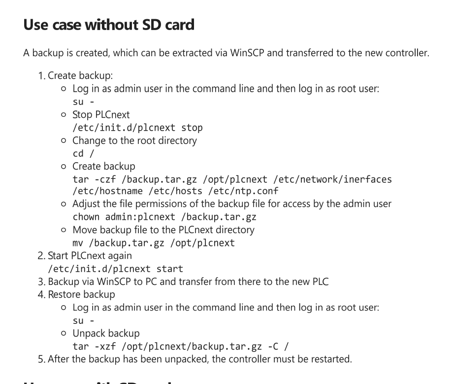

    The project is finished and runs on an SD card with part number 1043501. Now I want to distribute the software without sending the source code. Instead, I like to make a binary file or image file from an SD card and shipped to the customer. I want to know if it is possible to read the SD card and make an image file for both safety and non-safety SW. Later, on the customer side only by inserting the SD card on AXC F 2152 system will boot up.

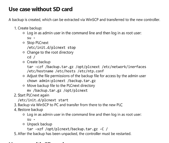

I got help from Phoenix in Sweden (especially thanks to Johan : ) for his great help) and the following solution worked for me. With this solution, you can make backups for both the safe and non-safe SWs, HMI, and even users.
First Download the project on the HWs and then execute the following commands:
